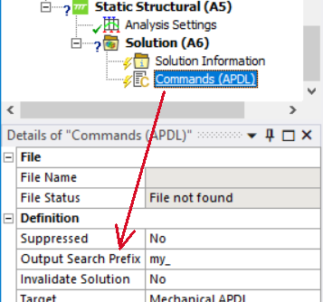

      You would need to use an APDL command snippet. That is what the "Pilot Node APDL Name" is for:
      This is meant for APDL scripts that you would place under the analysis branch or solution branch. You enter a variable name, and this variable will contain the ID of the node. I named it "My_pnt1" above.
      If you want to measure the distance to some other point after solution, you would insert a command snippet under the solution branch, and probably use *GET commands to get the location of the pilot node and a different node (placed in a named selection, and use CMSEL to get the contents). Then you can compute the difference and store in a variable. If the variable begins with "my_" it will be printed in the Details of the command snippet:
      Or you could write to a file using APDL commands CFOPEN, *VWRITE, CFCLOS. Or maybe you can just see the value in the Solution Information.
