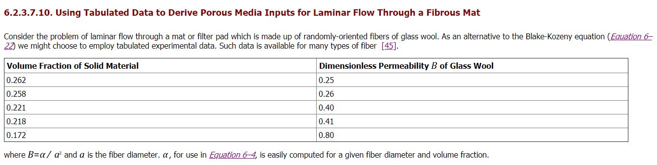

SubscriberMy problem is that I keep getting this error of Segmentation fault due to the zero flow at porous jump boundary. I tried to create cell zones just above the porous jump boundaries and set their Y-velocities as '0' to ensure that there's no slip in-situ boundaries. It didn't work out. Also for the values of porous jump boundary condition, how do I assign them?(I know that thickness is '0').

Ansys EmployeeAdd some screenshots so that we understand geo and model. For proud jump parameters follow the guidelines documented for porous cell zone condtions.Â

SubscriberOk Sir, I read a couple different sources and manuals of ANSYS which says since it behaves like a membrane it's thickness must be set to "0". If it shouldn't be zero, How do I decide the value?I have a mesh system of 5000mx5000m and 40000 elements(grid) in it.Actually, reaction is the primary cause of the fatal error,at first our system didn't have this reaction part,and it worked out well.Reaction is causing a problem at these boundaries but I cannot find why Sir.Also I read that discrete phase boundary should also be activated if you're dealing with porous jump.I did also activated it,still no solution.Do you think the reason that I keep getting error is the values?I need to find out how to set these values of FACE PERMEABILITY(default:1e+10),thickness,pressure jump coefficient,and thermal contact resistance(default:0.1).Where do I find these values or how do I calculate them for my system of 2D planar?I'm also looking for.Thank you very much.

Ansys EmployeeWho did till you all that regarding thickness and discrete phase? Which references?
Regarding parameters: check my first reply . If you do not have data stick to default and high permeability membrane or just do not use porous jump.

SubscriberSir, don't worry about the cell zones now bc me and my professor just figured out why its not working. As you told me, the default values of the porous jump boundary condition has to be assigned regarding to the constructed system.For our system, the size of one grid is 50mx50m so thickness could be at most 50m(isn't it right?), now I have to find the corresponding values of pressure-jump coefficient(C2) and face permeability(default:1e+10).And then I will try it out again.

Ansys EmployeeIf the thickness of the membrane is 50 meter then you need to give as input in the porous jump panel. The same applies by the way for the normal porous zone conditions. The C2 term is relevant for turbulent flows (or higher velocity= higher inertia). Actually setting all porous parameters requires either measurement of pressure loss, or correlations or input from the manufacturer.Â

SubscriberSir, now everything has cleared in my mind. I left the value of face permeability as default, i.e. 1e+10, thickness of the porous medium as 50 m and C2 value as "0". As for C2 value, I read through ANSYS manual that it could be assigned as "0" for laminar flow simulations just like you said bc it's actually for turbulent flows. Unfortunately, when I run the program it still doesn't respond, no solution. I keep getting the error segmentation fault "zero flow" at porous jumps.Please see the screenshot I shared.The video you shared earlier actually explains very well how one could derive the coefficients of a porous region. Could we apply the same procedure you did?(curve fitting in excel by referencing the values of VOLUME FRACTION of SOLID MATERIAL and DIMENSIONLESS PERMEABILITY BETA of GLASS WOOL) They are a bit strange for my case since our porous jump is actually a transition zone between marine sediments, imagine 3Â layers(bodies) and these porous jumps behave like membrane which allow water liquid flow and passes through them.So, for that kind of a membrane can we talk about some properties to be useful to extract the coefficients by curve-fitting them in excel? If so, which values(I mean you derived coefficients from experimental pressure and velocity data and for laminar flow one can derive coefficients by volume fraction of solid material and dimensionless permeability beta of gw) and how ?
