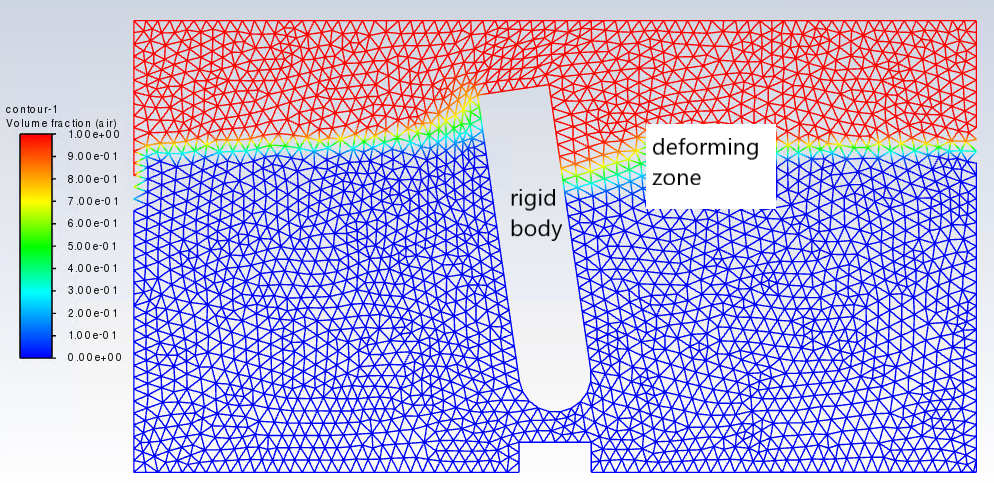

I have been using Example 3 from the UDF manual for my simulation but I keep running into a strange result. I am simulating a flap that rotates back and forth when it is struck with an ocean wave using mulitphase VOF and open channel wave BC. I am trying to run the exact same thing as https://www.sciencedirect.com/science/article/abs/pii/S0029801815001705.
So the mass of my rigid body is 33kg, and the moment of inertia is 1.84 kg*m^2. The dynamic mesh is updating and remeshing just fine, so I am not having any issues there. The issue is this: each time I calculate the solution, the rigid body almost immediately "falls" over. At the point it falls over, there is no presence of external forces (such as moving waves), other than hydrostatic pressure. However, the hydrostatic pressure shouldn't cause the flap to just fall over. I've even tried to use  sdof_prop[SDOF_LOAD_M_Z] = 1000; to simulate a torque on the rigid body to try to restore it back to equilibrium, but nothing seems to work.

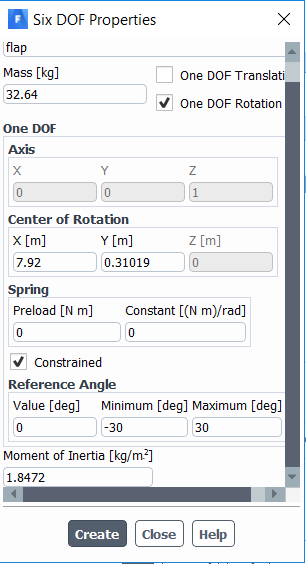

What do you mean when you say "if I just rely on the GUI"? As in, using the Six DOF Properties (picture below) instead of writing a udf?

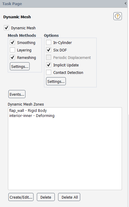

Regarding your second suggestion, I only have 1 rigid body (OWSC) and 1 deforming area. I did not model anything as passive. The deforming zone re-meshes just fine during simulation.
