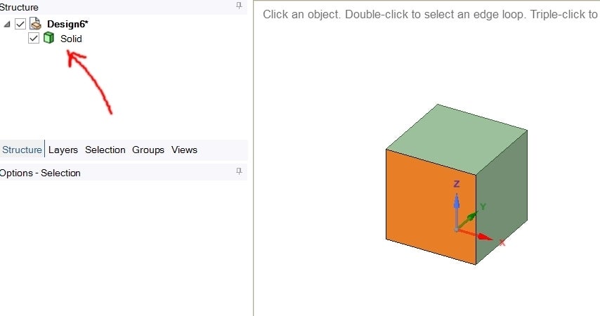

I will have to check with the development team to see if this can be done.
The syntax for the selection of the face (using the Index values) is
Selection.Create(GetRootPart().Bodies[0].Faces[0])
and for the body it would be
Selection.Create(GetRootPart().Bodies[0])
If you are using the Smart ID, it is Selection.Create(Body1)
I'm not sure if there is a way to have the script automatically select the parentÂ
