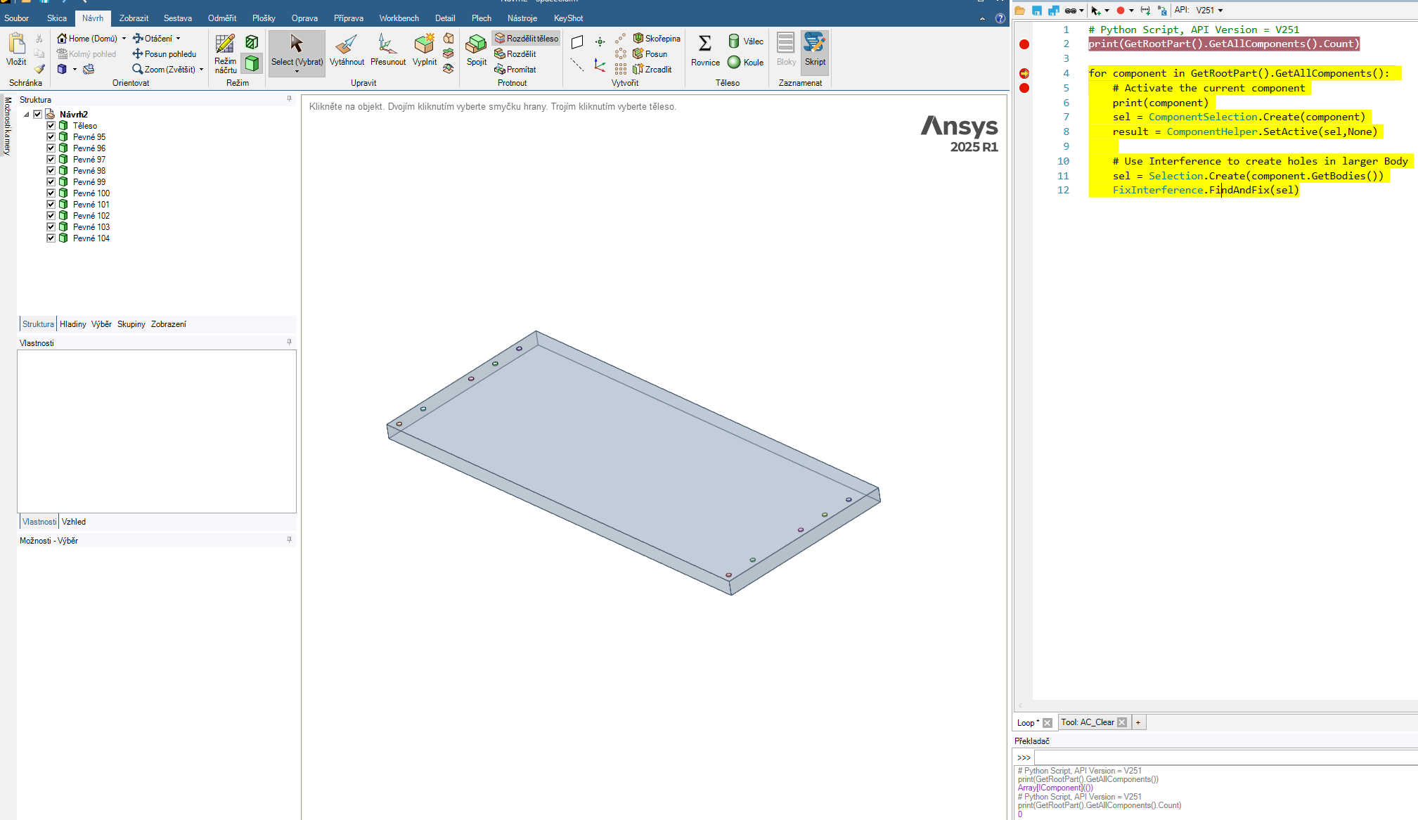

Is it possible to use a script(# Python Script, API Version = V251) to find models that are inside other models and then subtract them?It's about ajdustin cabinets parts, where are joints represented by model. see simple example.
I want to find all inner models and remove them and before subtract them from whole panel.
Now I am able to go through parts in document, but I cant find the way how create condition for it.
Thank you for any answer.
Kind Regards.
Pavel

What I can't figure out is how to use a loop to go through all the models in the drawing and subtract the models defining the hole from the large piece.Â
The image of the part I sent is only part of the entire assembly; it will be a kitchen with many more components. If this can be solved, the customer will probably purchase SpaceClaim.I didn't mention that I am a SpaceClaim sales representative in the Czech Republic.

The target is to make subtract of the models(bodies) which are all of their volume inside the another (its cabinet's parts).
It's simplyfy for one part but in the reality there will be a lot of them. This is one cabinet from the customer as example. Whole kitchen will be here in future.

SubscriberIt seems like most of your bodies are planar/cylindrical. In that case you could compare the bounding boxes to see if they overlap. With more generic shapes the bounding boxes could overlap but not the bodies themselves which could cause problems when you try and subtract them.Â

SubscriberIf you wanted to use the interference command like you had earlier, try something like this:
for component in GetRootPart().GetAllComponents():Â
  # Activate the current component
  sel = ComponentSelection.Create(component)
  result = ComponentHelper.SetActive(sel,None)
  # Use Interference to create holes in larger Body
  sel = Selection.Create(component.GetBodies())
  FixInterference.FindAndFix(sel) -

SubscriberNone of your bodies are in a component in that example. The bodies are under rootpart
