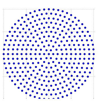

SubscriberI would like to know any script that will generate the dipoles in below mention pattern in the FTDT environment. in the XY plan

Ansys EmployeeHi Array,nThanks for posting your question. I take the liberty to reply on behalf of my colleagues Array I don't think we really have any script example doing exactly this, but I don't think it is very difficult. The basic idea is to run 2 nested loops, one on the angle (theta) and one of the position of the dipole for a defined theta, and calculate the xy coordinates.nFor example, it could be something like:nntheta = 36; # number of angle pointsnnr = 10; # number of point along each radiusnrmax = 5e-6; # max value of the radiusntheta = linspace(0, 360, ntheta);nr = linspace(0, rmax, nr);nfor(i=1:ntheta) {n for(j=1:nr) {n x = r(j)*cos(theta(i)*pi/180);n y = r(j)*sin(theta(i)*pi/180);nn adddipole;n set(x, x);n set(y, y);n }nnNote this script is probably incomplete: for instance, it will add a dipole at (0,0) for each value of theta while you probably only want 1 and there might be duplicate for theta=0 and theta=360. nViewing 1 reply thread- The topic ‘Script for Generating of evenly spaced dipole in a circle FTDT’ is closed to new replies.
