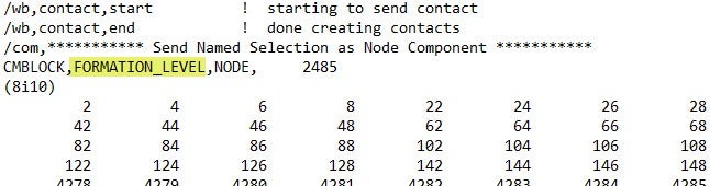

I am trying to assign the COMBIN14 command to a volume's surface, but I cannot find the way to do that. What I am doing is listed as follows:
1) I assign a named selection for the surface (the name is, for instance, "FORMATION_LEVEL")
2) After that, I try to find an ID for the named selection in the *.dat input file. The only I can find is the following:
3) Finally, I try to write the snippet for defining the spring (I do not know how to identify the named selection):

/SOLU
Please let me know how could I write the ID for the named selection. Thank you very much in advance!
