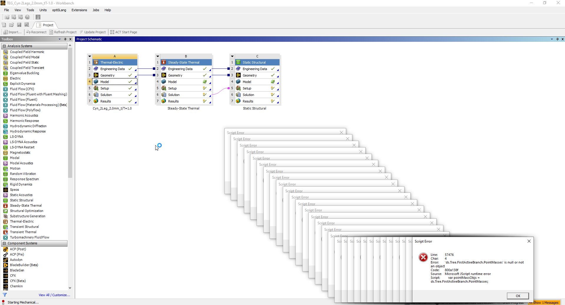

Script Error problem in ANSYS WB
    • shink
      Bbp_participant

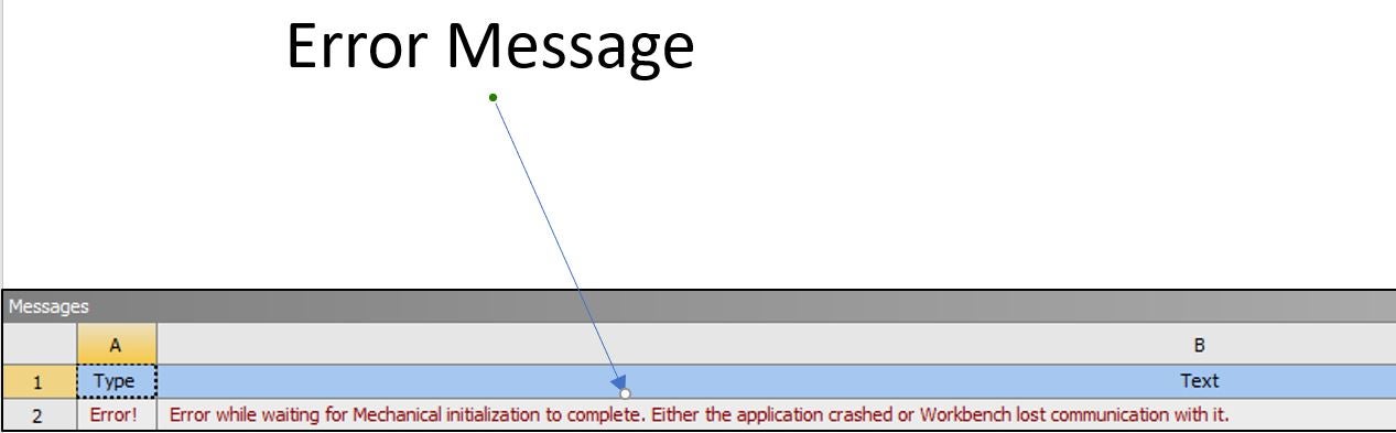

      When I start ANSYS WB, it's OK but I meet the problem as soon as I try to run my projects.
      I attached file what the problem is included rthe error message.
      And I uninstalled and reinstalled ANSYS for several times, but it couldn't work.
      Please solve the problem ASAP, I have to perform my dissartation and research project.

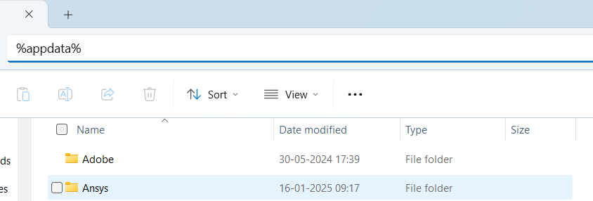

    • Rajeshwari Jadhav
      Please rename the Ansys folder (%appdata%) to ansys.old and try to relaunch the application again.

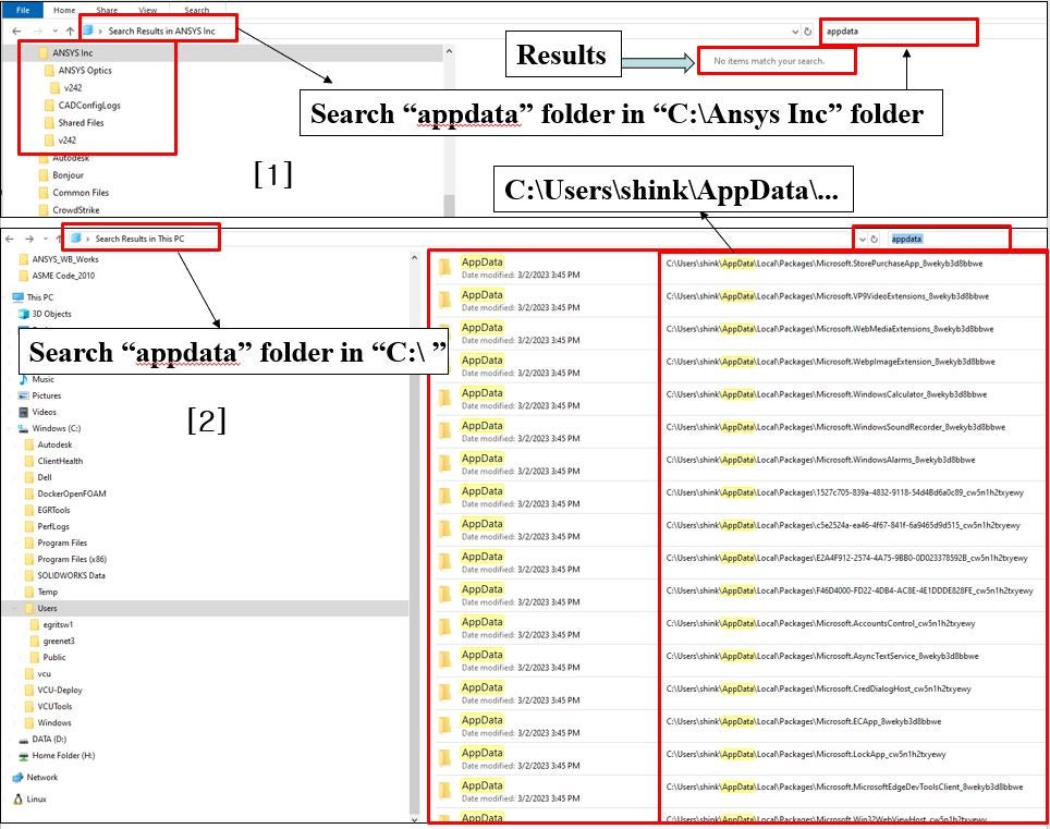

      Thank you for your reponse, but would you explain it precisely more?
      I tried to find the "appdata" folder in [1] "C:\ Ansys Inc"  and [2] "my computer:\ C:\ and D:\...." , but I couldn't find the "appdata" folder related to ANSYS as an attach file.
      It's a urgent problem to me.
      Thank you.

    • Rajeshwari Jadhav
      No need to search it, just mention %appdata% in directory and then rename the Ansys folder to Ansys.old.

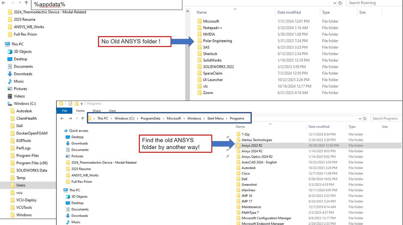

    • shink
      Bbp_participant
      Dear Mr. Rajeshwari Jadhav
      Thank you again, but I couldn't solve it yet as an attach file.
      Using the "appdata" , there was no ANSYS folder like your picture, the other hand I found the old Ansys folder as "ANSYS 2022 R2" as an attach file.
      Do I change the folder name from "ANSYS 2022 R2" to "ANSYS 2022 R2.old" ?
      Thank you.
      Sincerely
      Kyuin Shin

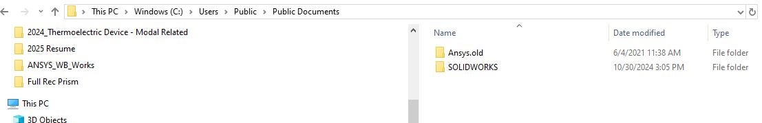

    • shink
      Bbp_participant
      And I found Ansys folder ad an attached file and changed "ANSYS" to "ANSYS.old" folder.
      Sincerely
      Kyuin Shin

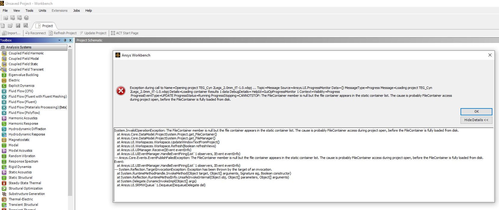

    • shink
      Bbp_participant
      I changed it, and I met another problem that I could turn on ANSYS WB but I couldn't run project file.
      The new error was occurred as an attach file.
      I may remake the project again.....
      Sincerely
      Kyuin Shin
