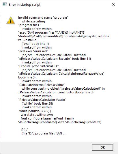

Forum ModeratorWhy has the path got [ ] in it? Remove any "odd" characters from the path and try again. Also, maybe try posting somewhere sensible?Â
