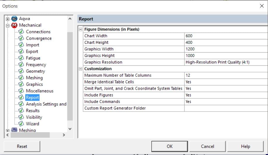

      Now you can insert a Figure in all the results and increase the graphics resolution as shown in the image below:
      Go to Tools>Options>reports and change the graphics Resolution, width and height as per your requirement.
      After doing these settings you can click on the "Report Preview" button to automatically generate the report which will contain high-quality images along with Units for all results.
