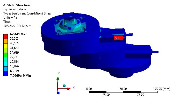

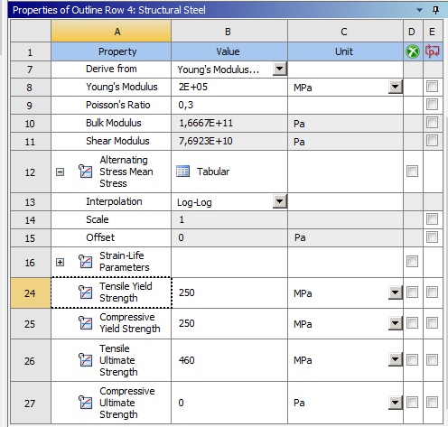

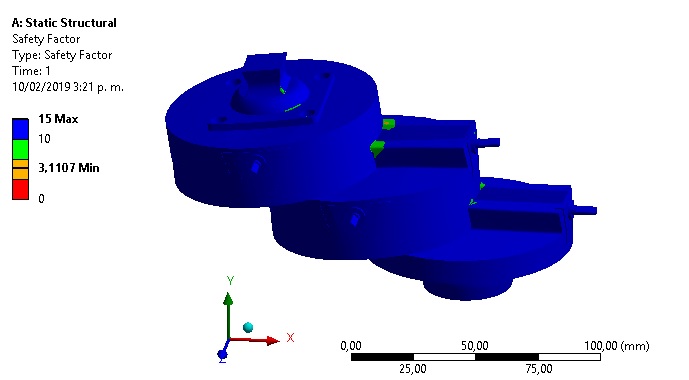

      I have a question about a  result of safety factor.
      I know that the safety factor is yield stress/largest VM stress in model.
      But in my simulation i dont know why the result is not correct:
       The result of (von-misses) stress was: 62,441Mpa
      The result of safety factor was: 3.1
      but is not correct because would be: 250/62,441 = 4
      I dont know what is the porblem, If someone can help me.
    • parkersheaffer
      Put a probe in your SF plot at the location where your maximum stress is occurring, also put a probe in to show where the minimum SF is occurring. Do these locations match? If they do verify that the component where the minimum SF occurs uses the steel you posted above. My guess is you have other materials in the model and the minimum SF is occurring on a material with a lower yield.

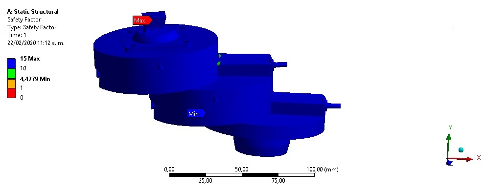

    • Anavasquez91
      Thank you for your answer.
      It is true that i used two different materials in this simulation. I put a probe in minimum and maximum  where the safety factor is ocurring, this is the image, the value is diffetent than previosly beacuse i changed the values of forces, but still is different than  yield stress/largest VM stress.
      So my question is what method use Ansys to calculate in this case tha safety factor because is different than this form(yield stress/largest VM stress)?
      For this case the largest VM stress is: 43,42 Mpa
      Thank you!

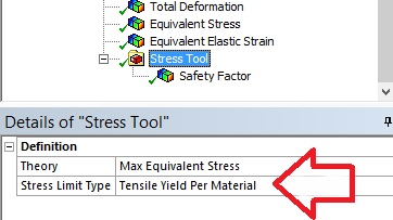

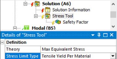

      The Safety Factor under the Stress Tool allows you to choose between Yield and Ultimate Strength. Please show what your choice was in the Details window.
    • Anavasquez91
      To this simulation i used Tensile Yield Per Material
