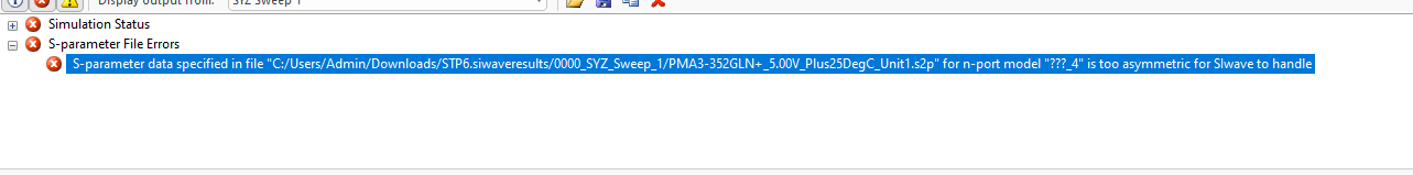

Aymen Mzoughi
Ansys EmployeeSIwave is unable to handle asymmetric S-parameters. The S-parameters file that you are assigning might refer to an active component. Active components are not supported in SIwave
May 16, 2025 at 9:54 am
Mohan
SubscriberOK. Thank you for the response. I want to do a full EM Co-simulation for the RF board. Kindly provide some input.
