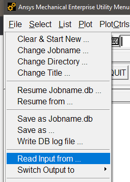

Does anyone know how I can perform the ANSYS Mechanical simulations using the APDL input files that Mechanical generates in .dat or .inp formats?
I would appreciate any help that you can provide.
April 15, 2022 at 1:51 amApril 16, 2022 at 4:32 pmmemo
SubscriberDear AnPham Thank you very much for your help. It works!

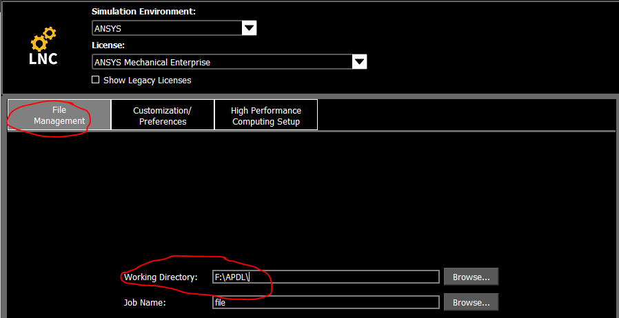

How can we change the working directory in ANSYS APDL? All result files are currently being saved in the C:\user directory.

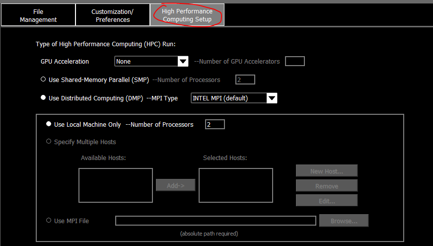

How can we set the number of cores to perform parallel processing?
Many thanks in advance.
April 17, 2022 at 2:00 amApril 17, 2022 at 4:50 pmmemo
SubscriberHi AnPham Thank you so much! Your help is greatly appreciated.
