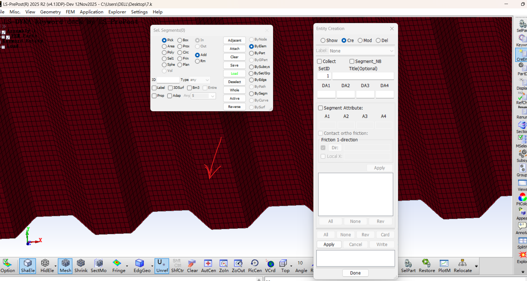

如何只选择波纹钢板的一个侧面
    • 1373620234
      把这个侧面作为迎爆面

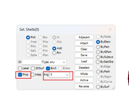

    • Vijay
      Hello User,
      Try with the Propagate and Angle option.This should do the Trick.

    • 1373620234
      我试过了 这并不可行 因为这样会把另外一侧也选中

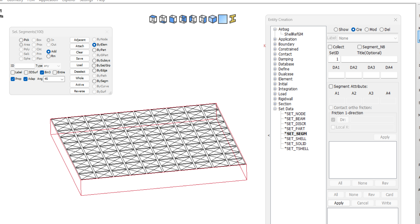

    • Vijay
      Hello User,
      You are working with solid elements or shell elements?
      For Shell elements, there is only one segment available which is probably your plane on which mesh is generated.
      For Solid,you have the option to select faces of solid element as segment.

    • 1373620234
      我用的是实体元素 如果用传播和角度的话会把板的另外一侧也选中
    • Vijay
      Hello User,
      You should be able to select the face of the solid element as segments.Please refer the img below.Maybe you feature angle is too high try with different values.
