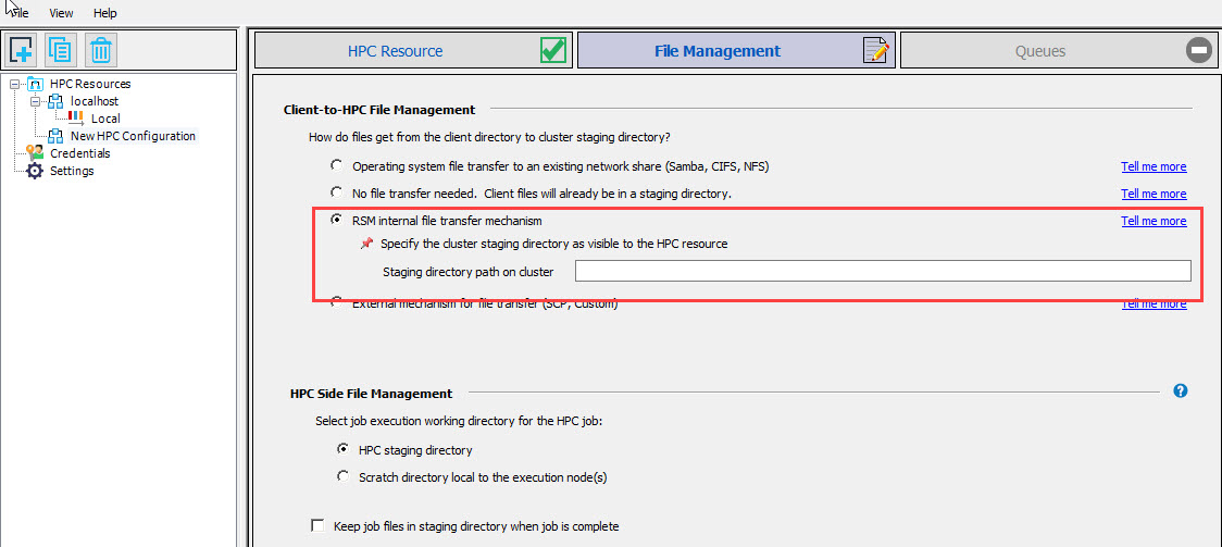

      I assume you are referring to the staging directory.  This is the directory that RSM copies your project to on the cluster.
      To change the location of the staging directory please do the following:
      On the client machine (I believe windows in your case) open the RSM Client Utlities:
      Start -> Ansys XX.X -> RSM Configuration xx.x
      Select the Cluster config on the left, and then click on the "File Management" tab on the right.
      If using RSM Internal file transfer mechanism, you will see /tmp there in the "Staging directory path on cluster"
      Change that to the location you want the files copied to.  Please note that the compute servers on the cluster will also need access to that path.
      Once you change the path, click "Apply" at the bottom, and then click on the "Queues" tab.
      That will save your settings.
