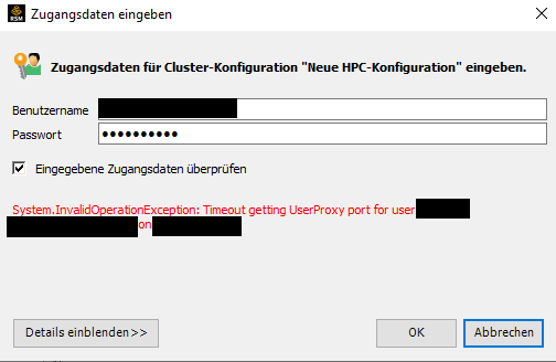

SubscriberI am trying to connect to the cluster and the Ansys v212 installation on the HPC cluster. At RSM Configuration on my local machine I get the Error Message: "System.Net.Sockets.SocketException: A connection attempt failed because the remote host did not respond properly after a certain period of time, or the established connection was faulty because the connected host did not respond xxx.xxx.xxx.xxx:9212".
The following ports are opened by the firewall on the cluster:
9212/tcp
11212/tcp
12212/tcp
13212/tcp
"PortRange" value="1000-1010" also /tcp,
"SocketTransfererPortRange" value="30000-30010" also /tcp
The following three processes are also running:
/usr/ansys_inc/v212/RSM/ARC/bin/ArcMasterService.exe -noshutdown
/usr/ansys_inc/v212/RSM/ARC/bin/ArcNodeService.exe -noshutdown
/usr/ansys_inc/v212/RSM/bin/Ans.Rsm.Launcher.exe -noshutdown

SubscriberI tried the approach and now get a different error message: "System.NullReferenceException: the object reference was not set to an object instance."
