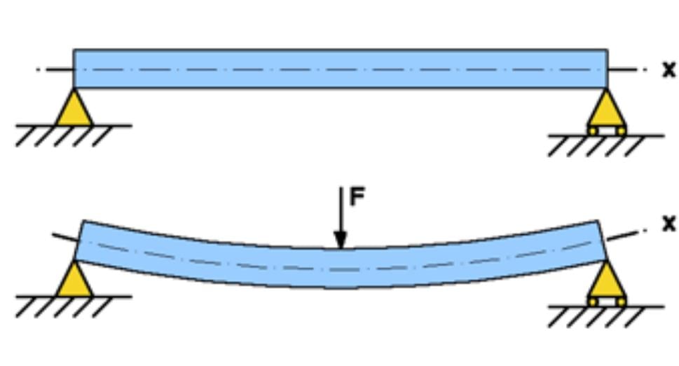

Here is a sketch of a simply supported beam, with a pinned end and a roller end.
This is very different from a fixed end and a roller end.
With a center load, the shape of the deformation for a fixed-roller is very different to a pinned-roller beam. Do you see that the tangent to the beam at the left end has a zero angle, while for the pinned-roller case, there is a non-zero tangent angle on the left end of the beam.
What end conditions do you really want on your beam: Fixed or Pinned (simply supported)?
 I think you want a Pinned left end, even though you are saying Fixed.

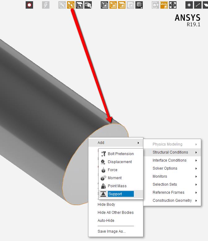

SubscriberIn AIM, the interface is simplified, so to get a pinned end on a solid beam, you open the Geometry and draw a line across the end to form an edge on a face. You also put a plane in the center and Split the face so you get an edge in the center to apply the Force.
There is a line at both end faces.
Then in Physics, you Add a Structural condition, and add a Fixed Support at one end but you pick the Edge not the Face. A face can rotate around a fixed edge, but a fixed face can't rotate at all.
Then you Add a second Structural condition, it is the User specified Support, and you Fix the Edge in Y only, and leave X and Z free.

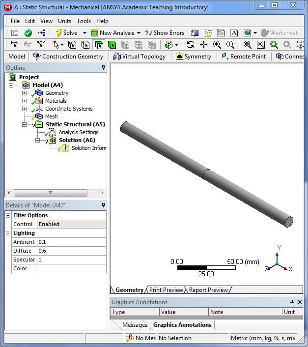

SubscriberOpen ANSYS Workbench 19.1, drag a Static Structural onto the Project page, double click on Geometry and draw the rod and divide the face at the center, then double click on Model to start Mechanical. You will see this:

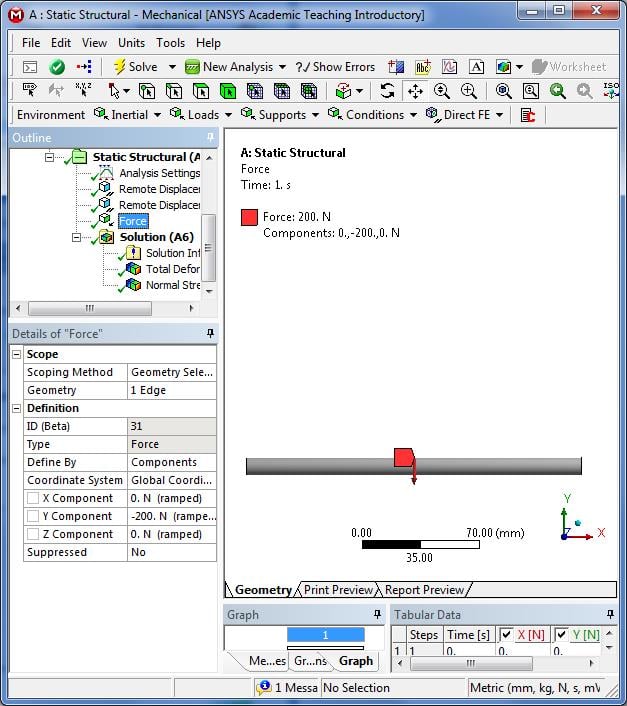

Now create the Roller support on one end by picking Remote Displacement.
Pick the face and assign a 0 Y displacement.
Now apply a Remote Displacement to the other end and 0 everything by the Rotation about Z, that is a Pinned end.
Now apply the force.
Solve and create a Deformation and Normal Stress plots.
Peter

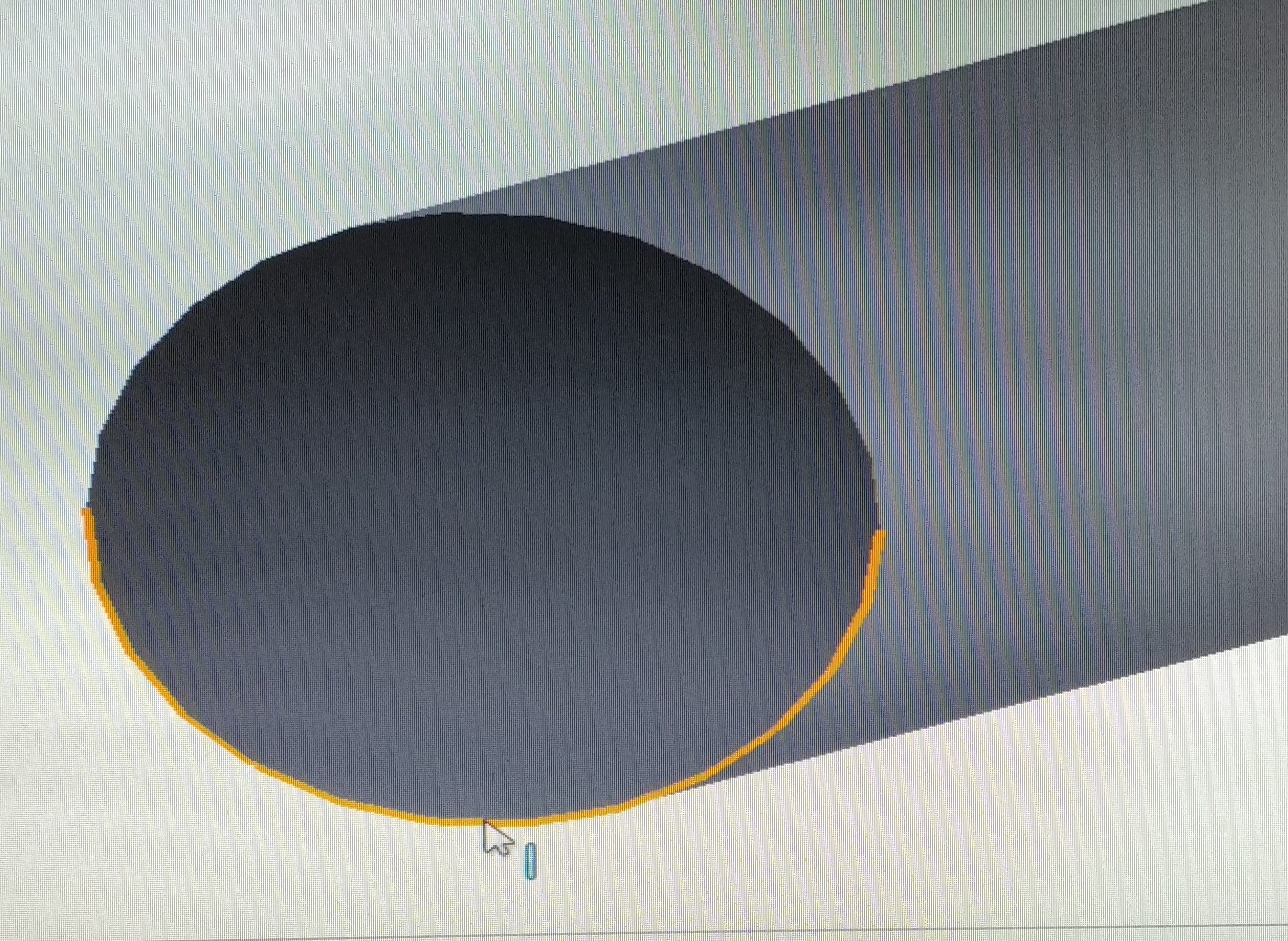

SubscriberSir instead If I apply constraints of "fixed support" and "displacement" to the two lower "half semicircle"( as shown). Is I'm doing right ? for simply supported beam ( having pinned at one end and roller at other).
What is the problem if I apply constrains to the bottom two points? ( Or their any way to get the same result by using point and semicircle selections).
September 23, 2018 at 12:02 pm
peteroznewman
SubscriberMaking a pinned connection to ground is like making a hinge for a door.
When I drew a straight line across the face, that made a pinned connection that could pivot because it was a straight line. When each node along that straight line has a fixed support, that prevents translation, that doesn't prevent the face from rotating about the line. Now consider the case of the half circle. The nodes at the start and end are in the same position as they were for the straight line, so could make a pinned connection if you only did those two points. But as soon as you add nodes around the rest of the semi-circle, those nodes are not allowed to move, so you just turned it into a fixed support and not a pinned connection.
One point on the bottom is fine for the roller constraint. One point on the bottom is insufficient for the pinned connection. A single point doesn't create a hinge axis. You need two points to do that, and not any two points, but two points spaced in the Z axis at the same Y coordinate, if you are applying a Y force in the center. If you use one point on the roller end, what is wrong with one point for the pinned end is it leaves the rod free to spin around the line connecting the two points. FEA solvers can't solve a Statics problem when a body is free to spin with no resistance.
