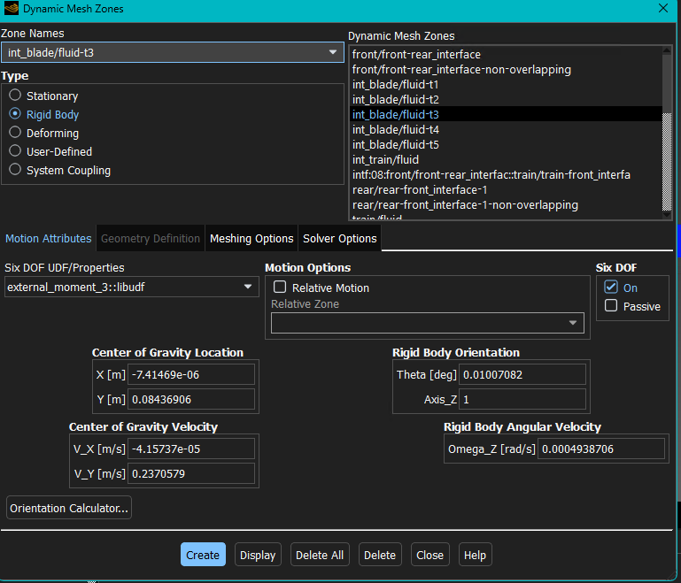

I simulate a very large domain that is over 1km long. It also has a rotating zones (a 2D rigid body motion). The rotating zone that is positioned in the global reference frame center works normally. However, now I have several rotating zones where the farthest is almost 1km away from the origin. Aparently I have a numerical round up error that is acumulating after each time step. After some time the mesh grid points drift away which causes mesh deformation of the rotating zone and incorrect boundary conditions at the wall (fluid velocity at the wall gets very high). How can be solved this issue? To somehow update the center point of each rotating zone?

SubscriberIt is transient, with time step size 0.0008s. It's a model of a 1km long train tunnel with windturbines installed in different positions along the tunnel length. The train moves using layering method while the turbine rotates using rigid body rotation approach.

SubscriberIt's quite a long duration, at least 70 seconds. For the turbine movement it is sliding mesh. I tried to use a local reference frame for the turbines but I didn't find a way how to do it. The rotation is also controlled by an UDF that reads turbine's rpm and calculates torque resistance simulating a generator.

SubscriberA lot of time steps, yes. But the turbine grid point start to drift immediatelly and error gets so big that after about 4 seconds the calculation crashes.

Forum ModeratorCheck the turbine centre and axis definition. Then check the rotation force can only spin the turbine zone.Â

SubscriberI did that already. It is interesing that the turbine grid points start to drift even before the turbines start to rotate. I notice the drifting by looking the values of Center of Gravity Location and Center of Gravity Velocity. They should remain at 0 which is true only for the turbine that is centered at the origin of the global coordinate frame. After some time when the results get unphysical I can see with my eyes how the turbine mesh gets deformed.
