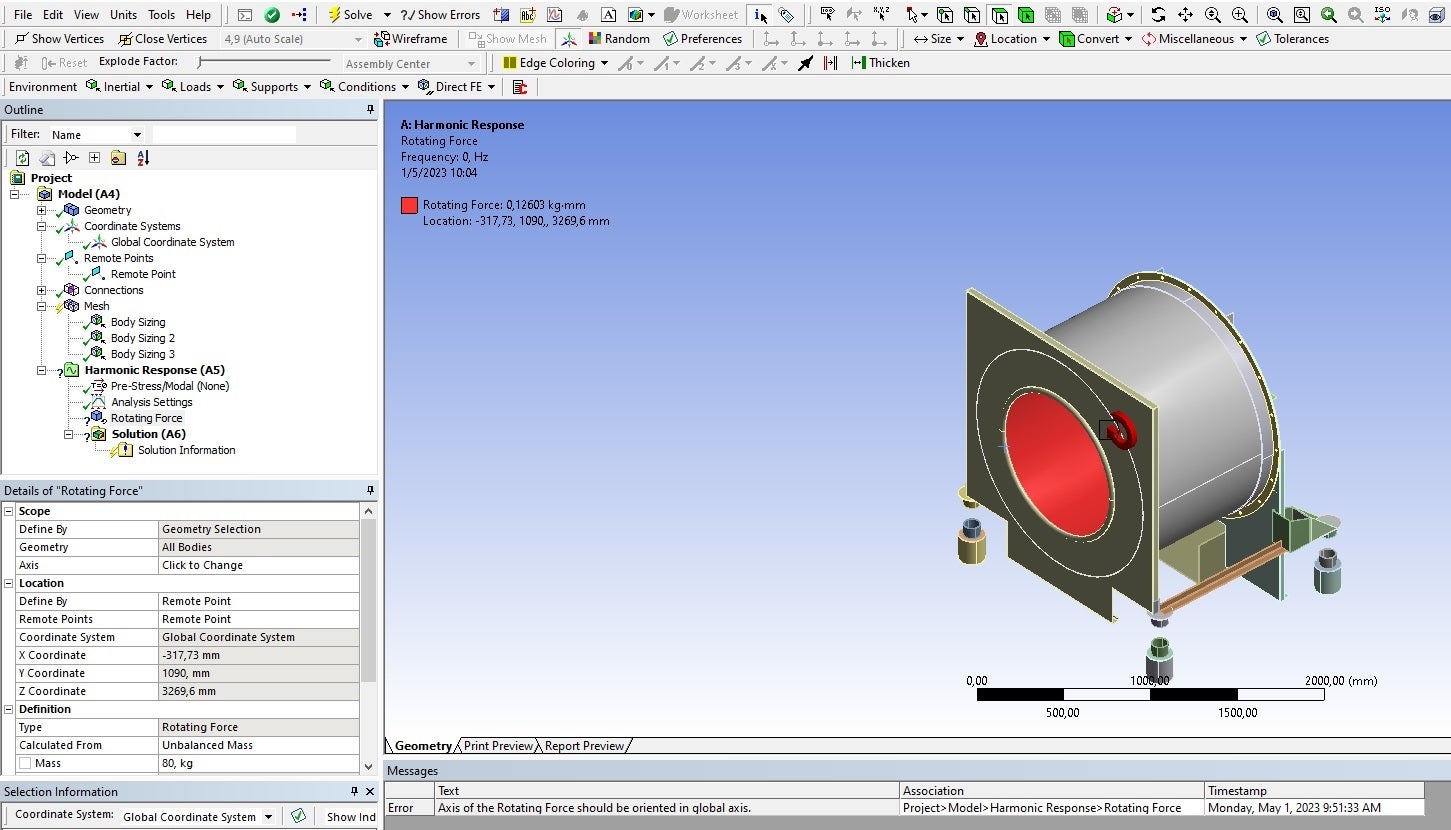

Juan Pablo Aruchari Flores
Subscriber -
May 1, 2023 at 8:12 pm
peteroznewman
SubscriberThe axis of the Rotating Force should coincide with or be parallel to one of the Global Coordinate (X, Y, or Z) axes.
- You don't show a Global Axis Triad in your image. If the geometry does not have the axis of rotation parallel with a Global Coordinate axis, open the geometry in SpaceClaim and use the Move tool to orient the axis of rotation to be parallel with a global axis.
May 2, 2023 at 3:42 am
SubscriberYes you are very right, thank you very much for the observation and greetings from Bolivia
