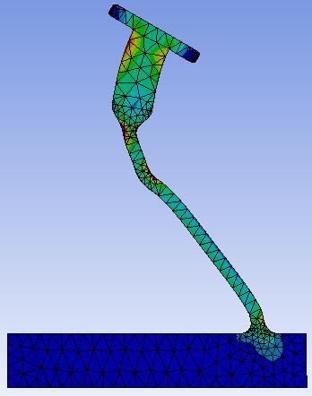

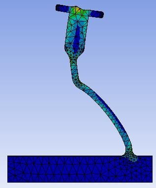

SubscriberI am trying to look at reaction forces on my part that would be caused by a rotation of the part. I tried using a remote displacement to apply a 30 deg rotation, but I think it deforms the part in a way that would be unrealistic. I applied it both to the center I would want to rotate it about, as well as the faces that would be near it. Would it be better to apply the displacement to the entire body?Â
(applied across top face vs applied at an edge through middle of top face, ideally what the part would be rotating around)Â

Ansys EmployeeHi,
Yes, remote displacement works by applying displacement one remote point, but that remote point controls the behavior of the whole related geometry. By applying direct displacement to the edge, you are making every point on the edge move the same amount, but if you have a remote displacement with behavior as rigid, that edge won't deform and moves like a rigid body. Points on the edge can move for different amounts in this case. (Imagine you have a stick, and you are pulling one end laterally, the stick can rotate and move but won't deform, that's how remote displacement with rigid behavior works).

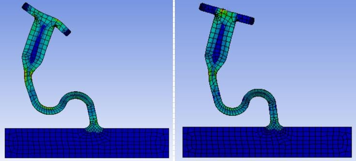

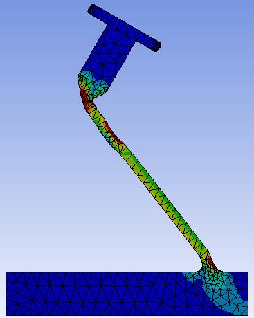

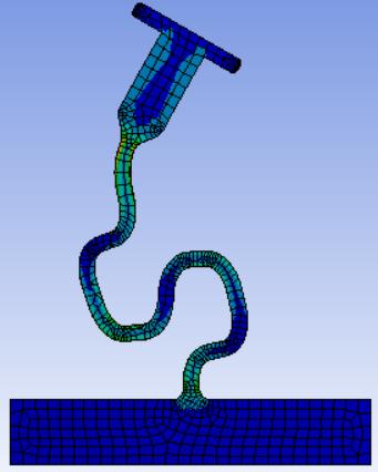

aquadragon19
SubscriberI see your point. I am trying to simulate moving the entire object above around a 'fixed location' (where I placed the edge). So I want everything rigid, but I when doing that in the simulation the top of the bar doesn't really undergo any stress. I tried applying the remote displacement to the whole top face, and the results are very different, so I guess what I am really struggling with is where the most realistic place to attach the displacement is. I attached a couple different examples below showing how where it is applied drastically changes the stress.Â

peteroznewman
SubscriberAnother part touches the top and causes it to move.
If you model that other part and move it, the top section will make contact with that other part and the top face will deform in a more natural way.
