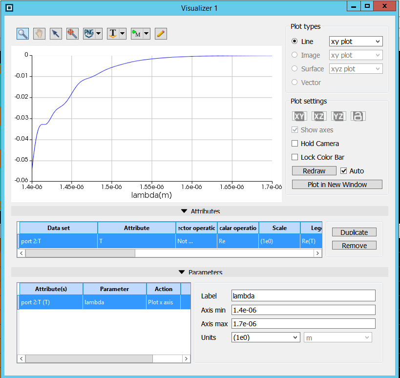

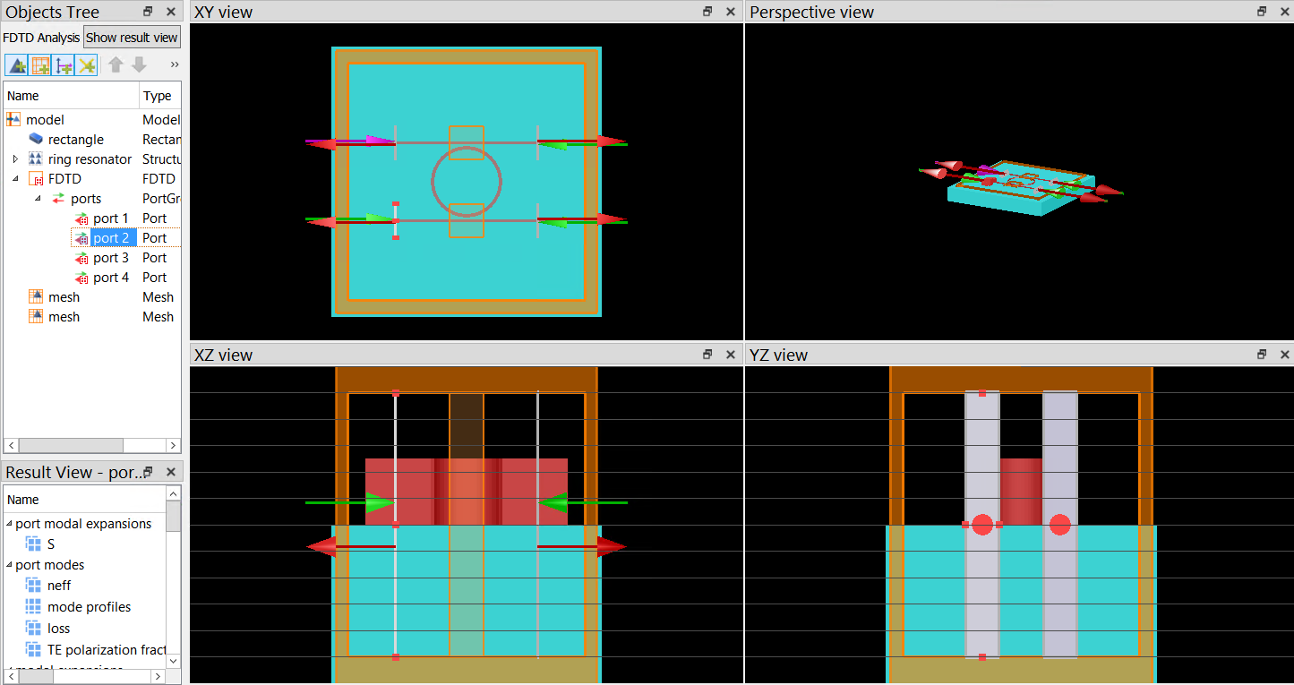

SubscriberThis is my simulation region:
This is the drop output I got:
I added the mesh override region at the coupling regions and added no nanoparticles here. But I got this output. I have no idea why it does not work.

Ansys EmployeePort2 is the source port? it is reflection.
Please check the transmissions. It might be due to small coupling.
you can also add override mesh to the particle since it is small.

SubscriberPort 1 (upper left) is the IN, port 2 (lower left) is the DROP, port 3 (upper right) is the THROUGH, and port 4 (lower right) is the DROP 2.
If the coupling is indeed small, what should I do? Because as I mentioned earlier, changing the wg width to 0.4 μm from 0.2 μm works.
The output that I have given does not have the Au particle, so I didn't feel the need to add mesh override region.

Ansys EmployeeAs your result shows, the coupling depends on both the gap and the waveguide size. When you could not find the coupling as expected, please optimize them, either the waveguide or the coupling region and gap, or both. I did not find any significant issue in your simulation settings from the screenshots.
Using override mesh or not is up to you. Simulation is a design process so you will need optimize some critical parameters of the device, with proper simulation settings. Please follow the online examples.
Please noite that this forum is to give help for general questions. It is not targeting a specific issue. If you have premium support privilege, please send us email for support.
We can also isolate the issues. For example, one post is for the case with nano particle, and the other for without nano particle.
