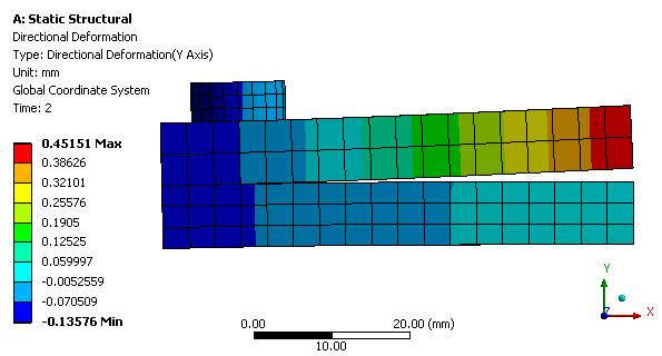

Rigid Moment X Deformable Moment
    • Fabricio.Urquhart
      The difference between each other is clear, I suppose that it influences in the body deformation. My issue is analyse the contact between the edges, so the body's deformation will not be analysed. Because this, I was using Rigid Moment. But the warning is "One or more MPC contact regions or remote boundary conditions may have conflicts with other applied boundary conditions...."

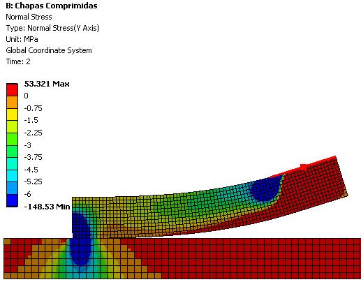

      I don't agree with the warning, but despite this, I tried with the deformable moment, only to see the results, and the warning changed to "One or more object is using a deformable behaviour but is applied to a collinear set of nodes. This is not recommended an can cause solver difficulties..."
      So which them is correct, rigid or deformable?I think thaht is rigid, but and the warning?
      Another result that I am not understanding why do not have compressive stress in the point that stay in contact after the load is applied.
      The picture comparing both of them is below:
      If anybody can help me, I will be greatful, I am doing my master thesis about steel bolted connections, so it involves a lot of contact problems.
      Thank you very much!
      Hello Fabricio,
      Please read the first warning..."or consider turning large deflection on."  Anytime nodal deformation is of any significant displacement, like more than an element size, you must turn on large deflection under Analysis Settings. Both of those results above are invalid unless the display scale factor is huge and not True Size.
      You ask why no compressive stress. That is because you have no down force. In the absence of a down force a moment can rotate the part up with no resistance.

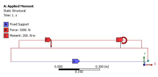

      I have created a similar model, but split the top body to apply the moment for a short segment on the right, and apply a down force on the long segment on the left.
      Below I plot the Normal Stress in the Y direction. You can see most of the body has a compressive stress.
      The applied moment is resolved into a high tensile and a high compressive stress on the short segment.
      There are no warning messages when this solves.

      Hello Fabricio,
      It looks like you have ANSYS Student 18.2, not AIM, which looks very different. The way you open my file is with Workbench, use File, Restore Archive. If you want to send me your file, you use File Archive and it will create a .wbpz file that you can Attach to your post.
      I configured my legend so the first number next to red was 0 and the first number next to blue was -1 MPa so that I could see the very small compressive stress that the contact generates when there are elements with -29 MPa in my model.
      I think I used rigid for the moment, but there wouldn't be a large difference in the contact pressure since that portion is lifting off.

      After I open the file you attached above in AIM 18.2, it looks like this...
      But now I see how to open Workbench from AIM.  I never did that before!
      I can now see your model.
       Here is your model result with the Legend edited with a 0 and a -1 value imposed.
      If you change the Moment from Deformable to Rigid, one warning message will go away.
      Replace the two edges with Displacement X=0 with just the bottom left vertex of the top body. That is enough to stop the body moving, and would leave those edges free to shear and rotate. The current BC prevents those edges from shearing or rotating, but that is what you want I think. If you do that, you have to apply more down force because there is not enough to prevent the body from flipping over as the moment is applied. Here is the solution with 3000 N of down force.
      AIM 18.2 Archive attached.

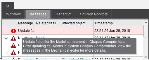

      Do you know if the warning "Large deformation effects are active which may have invalidated some of your applied supports such as siplacement, cylindrical, frictionless, or compression only." may disconsider the contact that I have defined between the edges?
      And when there is a warning saying that the contact status has experienced an abrubt change, it depends on the load's magnitude, isn't it?
      Regards, thank you for be patient...
      Fabricio
      Fabricio,
      In this case the abrupt change to the contact was expected, we rolled a part of the surface out of contact. In other cases, the contact failed and one body passed through another body. You have to look at the deformation results when you get the warning. The warning is generated when contact status changes, it doesn't only depends on the load magnitude because the magnitude has to be large enough to change the contact status.
      The other warning "may have invalidated some of your applied supports" is again something for you to check the results and look to see if anything is wrong.
      Peter

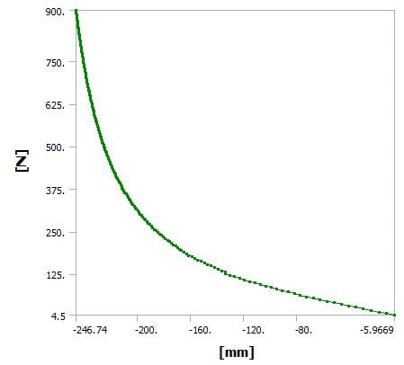

      I woud like to plot a graph where I can identify the geometric non linearity. I tried to plot Time X Displacement. But the displacement were linear.
      Can you help how can I plot this graph?

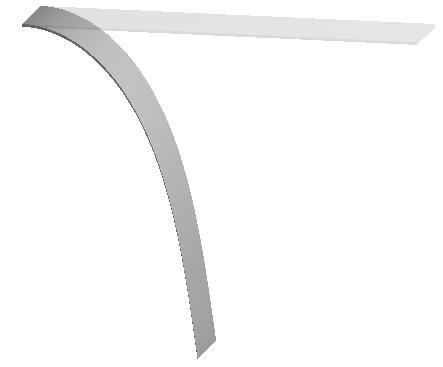

      Fabricio,
      A good nonlinear problem is the large deflection of a cantilever beam. Here I plot the tip deflection versus tip force in the Y direction.

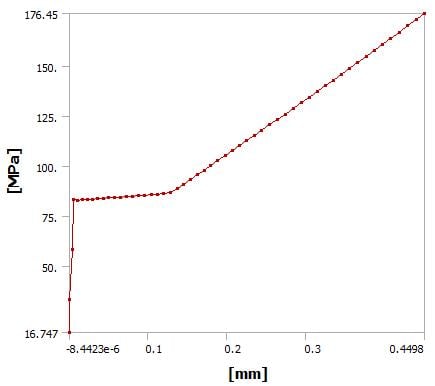

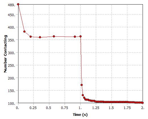

      Peter, ok, I know that there many tpes of nonlinearity. In my case, I am studying the contact nonlinearity. The final objective is plot a graph between Moment X Rotation of the bolt connection and analyse the stiffness of each one.
      I plot the number of elements contacting vs load, but it is wrong (the model is attached), I do not why. The graph between load vs displacement has to be nonlinear as the picture below:
      Fabricio, I made a video for another student of a fastener with bolt pretension applied to clamp two plates together. That discussion has an attached 18.2 archive. I don't see an attachment on your post.
      If I take my model and plot the maximum contact pressure under the bolt head vs. Y deformation of the tip of the top block, I get  the following graph. Note that I had to set the initial substeps and minimum substeps to 50 each to get 50 points on the graph. This shows a significant nonlinearity. The modified 18.2 archive is attached here.
    • Fabricio.Urquhart
      Let's try again.
      I plot the same graph, but it is linear. I think that I have problem in my model. But I could not find it.
      Thank you Peter for the attention!

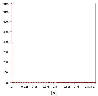

      Fabricio,
      I built this model with bolt pretension. I removed the previous graph that was X axis instead of Y axis. The Y axis deformation versus pressure is very linear, but I expect that.
      The number of elements contacting vs time (proportional to load) is very nonlinear.
      I will run it again without bolt pretension. I used symmetry to keep the nodes+elements<32,000 for Student license.
      I also used a solsh190 element that was made to use with a single element through the thickness while properly accounting for bending moments.
      Here is the same graph without the bolt pretension. Again, very nonlinear but just in the first substep.
      Fabricio
       I don't understand your graph, why is the normalized force not zero when the gap is open?
      I drew what I would expect a force vs. distance graph ought to look like for that model.

      The graph is normalized g/l and F/EA is the force applied, not the contact pressure. So when F > EA * g/l, contact occurs and you have the constraint u2-u3 = g has to be fulfilled.
