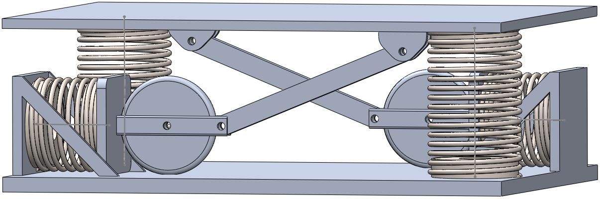

      I am fairly fresh to ANSYS and I would like to know how to conduct a rigid dynamics and magnetostatic study simultaneously within ANSYS.
      The general principal is that the assembly has 4 springs with magnets fixed at either end and when the springs are compressed due to a force applied the magnets fixed at either end repel each other.
      The output ideally should be a force vs displacement curve.

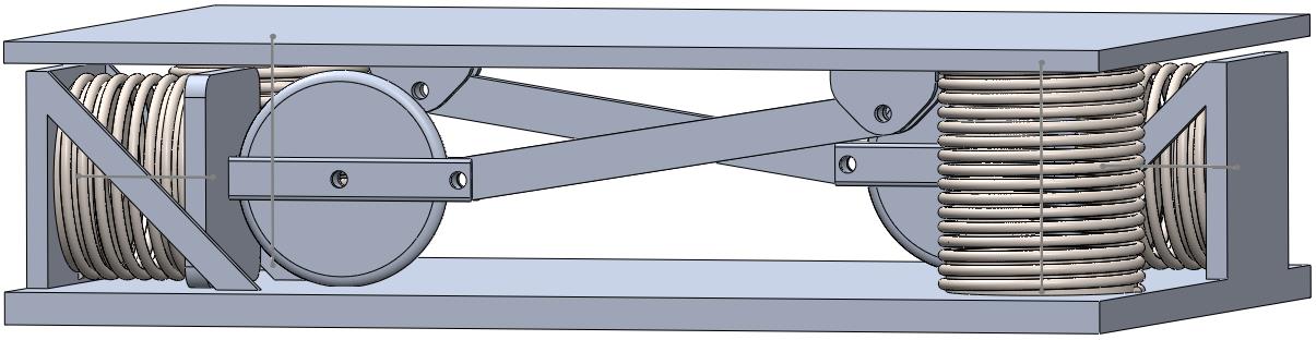

      Hi Peter,
      I have attached some photos of the system in its ideal start and end position.
      Yes i do have the magnetic properties.
      This is the assembly start:
      This is the compressed end point:
      Thank you
      Have you solved the magnetostatic model to obtain the magnetic force as a function of position of the small plates?  If so, you can insert a COMBIN39 spring and program it with the magnetic force vs displacement data to simulate the magnetic force in this mechanism.  You could then simulate the rest of the mechanism in a Static Structural analysis. I don't know if this COMBIN39 nonlinear spring works in the Rigid Dynamics solver. It does work in the Transient Dynamics solver.
