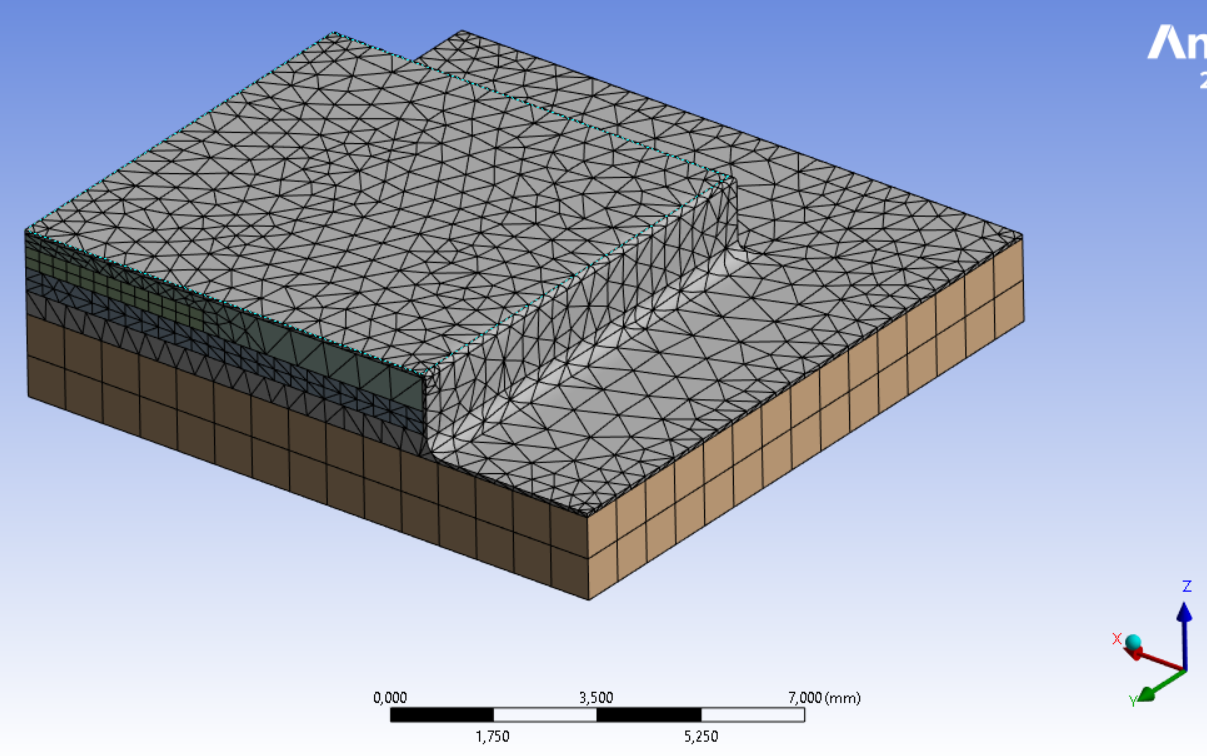

      I'm having trouble eliminating rigid body motion in my analysis. The solver fails always at 17% progress. The model is of a quarter symmetric BGA where the PCB has a fixed support and the cut faces have frictionless supports assigned. The load is a thermal condition applied to all bodies. All contacts are bonded, except for three rough ones with the coating on top. Formulation for the bonded contacts is set to augmented lagrange and the stiffness is updated every iteration. Running the contact tool reports no open contacts, all are closed and look normal. I have weak springs enabled.

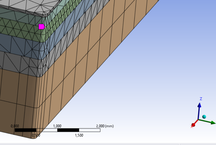

      The error message indicates rigid body motion. You can create a named selection for node number 957648 and check which body is unconstrained.
      Ashish Khemka
    • Frederik Zemlin
      Hi Ashish,
      Thanks for the response. The body in question should be fully constrained as it has bonded contacts to adjacent bodies. I have tried adding an edge blend as the node sits on a corner but it didn't help.
      best regards,
      Frederik
    • Ashish Khemka
      Hi Frederik,
      Try running a quick modal analysis to see if you find any rigid body modes.
      Ashish Khemka
    • Frederik Zemlin
      Hi Ashish,
      the modal analysis has no free body modes. I think I found the cause for the rigid body motion, a material had a wrong very large CTE assigned. But get an error now that the solution doesnt converge at time step 1250.
      best regards,
      Frederik
    • Ashish Khemka
      Hi Frederik,
      Can you please share the snapshot of the solver output?
      Ashish Khemka
    • Frederik Zemlin
      Problem has been solved. Had to set the normal stiffness to 0.01 and solver to direct.
