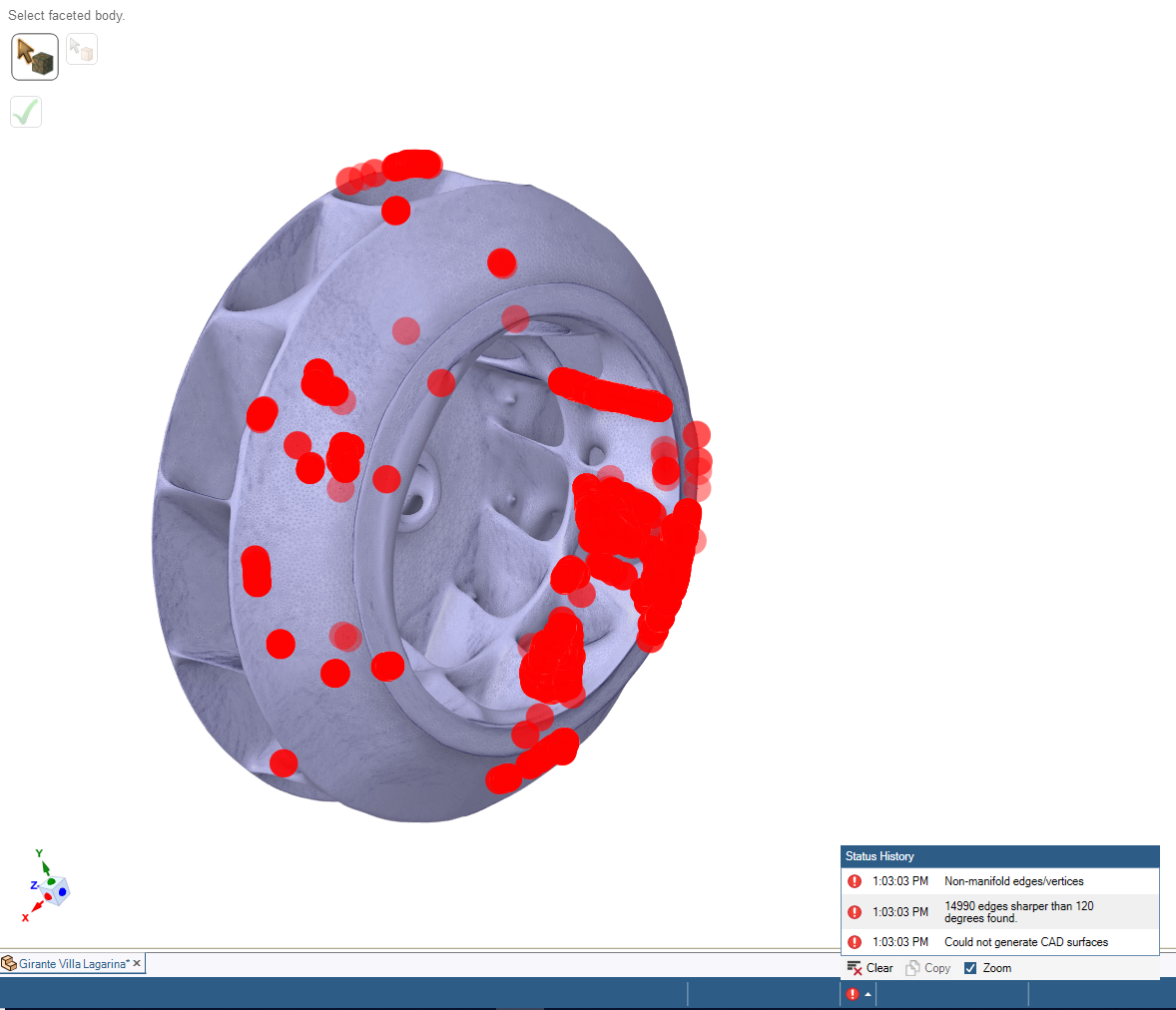

Ansys EmployeeYou will have to use reverse engineering tools shared. nIn such complex geometry auto skin may not work. You may need to do it manually. nAlso please check if you can take only one repetitive portion of this geometry. Use reverse engineering tools to create solid. Then repeat that solid to get full geometry. nPlease go through help manual for more details nRegards,nKeyurnHow to access Ansys Online Help DocumentnHow to show full resolution imagenGuidelines on the Student CommunitynHow to use Google to search within Ansys Student CommunitynMarch 3, 2021 at 9:15 amMauroTortora
SubscriberDear Keyur,nnThanks for your response. I will have look into the help manuals for sure.nIn the meanwhile, I think I have found the main problem: there are too many sharp angles.nI have tried to press the green V of the picture below but I couldn't solve the problem.nIs there a best practice to remove sharp edges? You can find one example below.nnThanks,nMauron
n
March 3, 2021 at 10:37 amKeyur Kanade
Ansys EmployeeYou can use Facets - Smooth or shrinkwrap options. nPlease go through help manual for more details nRegards,nKeyurnHow to access Ansys Online Help DocumentnHow to show full resolution imagenGuidelines on the Student CommunitynHow to use Google to search within Ansys Student CommunitynViewing 5 reply threads- The topic ‘Reverse Engineering, problems on STL file conversion to solid: non manifold edges/vertices, …’ is closed to new replies.
