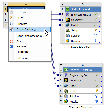

SubscriberStart with a Mechanical Model to use the same mesh for multiple analyses.
Export that Mechanical Model to save it as export.wbpz

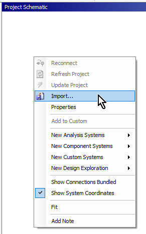

On a New Project, you can Import the Mechanical Model that was exported from a previous Project.
It shows up ready to start the new project.
Multiple subsystems that can be tied together in a new Mechanical Model and sent to an analysis system.

SubscriberThank you Peter! The Export/Import feature in WB is exactly what I am looking for. Cheers!
