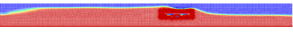

      I am performing a multiphase 2D open-channel flow using air (primary phase) and water (secondary phase).
      • The thing is that residuals never converge even if I change the mesh. And if they seem to converge, drag coefficient vary sustanciably (60% variations aprox.)
      For the graphics, in 2d don't pick any surfaces. You'll get a continuous contour as the solver will magically figure it out.
      I can't tell if you have supports under the bridge, remember in 2d there's no way for the water to get around these: that could cause some interesting results. If they're buoyant cells that may be different.
      Residuals & reports are mostly as expected. You may need to resolve the mesh near the free surface, but I can't see from the image. Generally in multiphase there is something in the flow (reflected waves, ripples etc) that are transient. The question you need to consider is whether these waves etc are altering the data you're interested in. Ie are you wanting to see the flow field and understand the range of drag, or see the speed/rate of any transient effects?

      BOI is fine, adaption is another option.
      Lastly, the acceleration is because you're forcing water through a smaller gap: where else will it go in a 2d model?

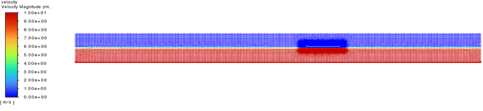

        Hi Rob, I have another question. When I simulate high velocity (10 m/s) for let's say 5.5 m height water, I get weird results.
        Density after initialization (red water, blue air):
        Velocity after initialization (10 m/s for the water 0 m/s for the air):

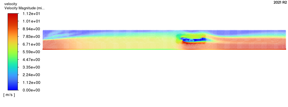

        After a lot of iteration water interacts with the structure, but a weird wave is created upwards as seen in the following pictures. Therefore, water height ends up being greater than specified in the inlet. It ends up being like this (not finished running simulation):
        Also, the velocity in front of the structure is reduced from 10 to 7 … Drag and lift coefficients are still computed with a velocity of 10 m/s but I don’t think this results are right…
      Looks like the water can't get under the bridge quickly enough so builds up. Have a look at flooding around bridges: it's an irregular problem!

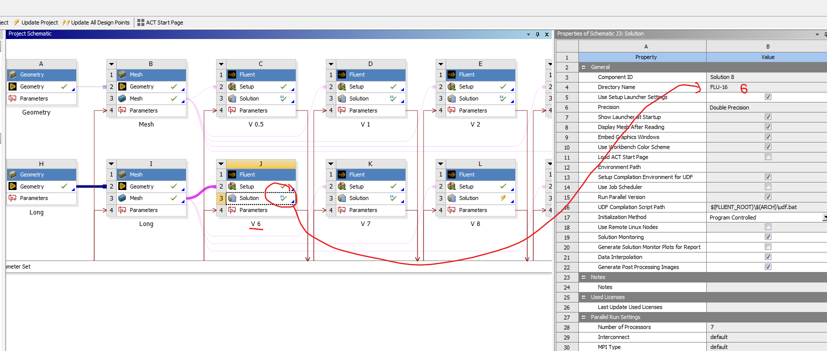

      Also, I have many files and solutions. Normally I run the simulations and then I ectract the resutls from the directory name folder. Is there any way I can change the name of it? Because when I enter in the folder I always have to check which FLU folder is for Velocity 6 (V 6) whereas I would like it to be saved in FLU-6
      The thing is that as I deleted previous FLUENTs, directory names were adding in number.
      In Workbench you can't rename files, that would interfere with the project workflows. If you run Fluent outside of Workbench you can. You can also export case & data from Fluent in WB to use externally.

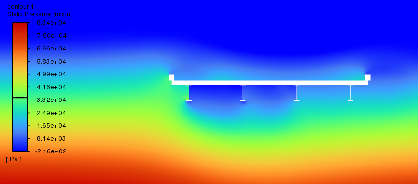

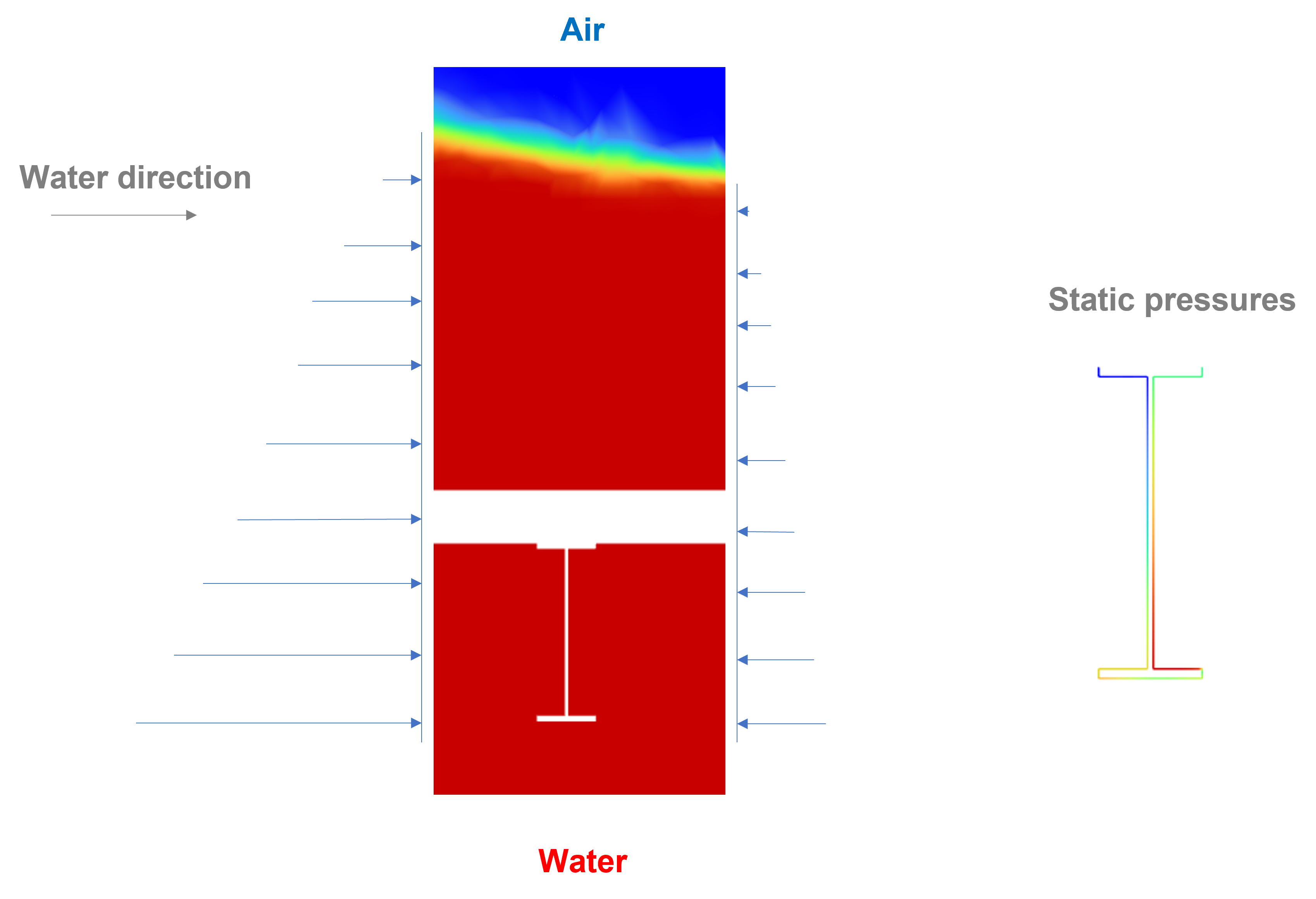

        Hi Rob, I have another question. This time is about pressures: static and dynamic pressures.
        I have checked some results and I quite don't understand this: static pressure is merely due to the column of water above the analysed cell. Therefore I assume that higher water column higher static pressures, but this is not the case when I check pressures, please see the image below.
        Here the water column is higher on the left part of the "I" section than the right side. Still pressures are higher in the right side than the left one. I think I am missing something related how static pressures are estimated.
        As far as I understand, dynamic pressure is calculated at the walls by using the velocity next to the cell.
        And static pressure is due to gravity as follows;
      • pv00170
        The following image shows static pressure of water flow around the studied bridge. I assume there might be some variation of static pressure due to velocity and/or turbulence?
      Static pressure is not the same as hydrostatic pressure, the latter is what you're asking about and is due to the mass off stuff above the location.

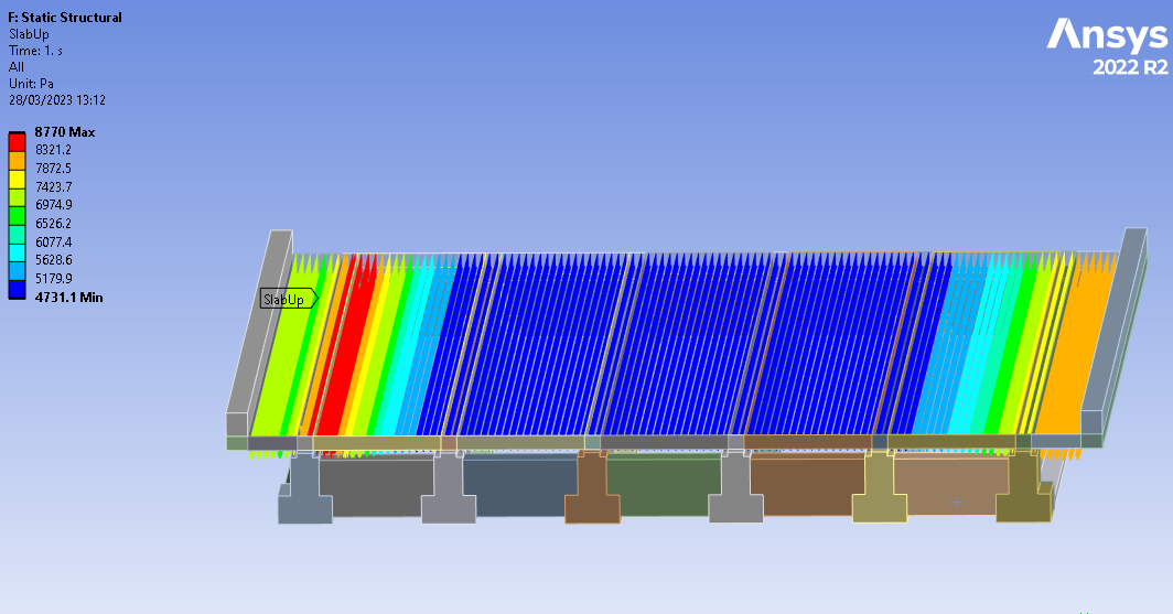

      Dear Rob,

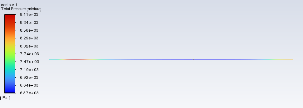

      When I export CFD pressures from Fluent to Static Structural or Transient Structural only static pressures are imported (therefore no dynamic ones).
      What can I do to import total pressures (dynamic and static).
      In the first picture there's the imported pressures in Static Structural (which correspond to the static pressures obtained in fluent) whereas in the second, the total pressures obtained in CFD.
      Please post a new thread - I don't do much with the FSI part of the code so don't know what's passed.
