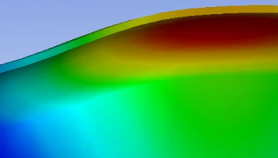

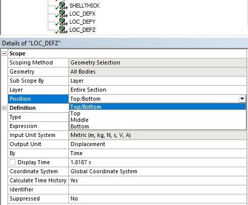

SubscriberI am simulating deformation of a Shell body (SHELL181). I want to know location of the top and bottom surfaces of this Shell body after deformation so I inserted user defined results as shown in the Figure below. However, there is no difference when I chose Top , Bottom ( at "Position" option).
December 23, 2021 at 4:34 pmRameez_ul_Haq
Subscriber,if you already are using a SHELL181 element, then just directly looking at the results of deformation means that you are actually seeing the deformations (that are supposed to happen) on the top face, as well as on the bottom face. I don't think any external user defined results are necessary.

Subscriber,SHELLTHICK is used to determine the thickness of the shell. Its not about deformations. What you are trying to do (as far as I have understood, you actually want to see the deformations of the top and bottom faces separately), can directly be seen from the deformations plots when you right click the solution. No user defined results are necessary at all.

SubscriberSorry for the unclear question. Now, I want to see the deformed shape in which different shell thicknesses were shown. Is there any option to do that? Because as you mentioned before, it automatically shows the change of shell thickness. However when I plot the result of deformation (below picture), the shape is deformed but the thickness is still uniform ( It must be different as shown in the previous picture with contour of thickness). In my opinion, because it is shell body, actually, there is only one grid-layer, so Ansys cannot plot the change of thickness as for solid body.

December 29, 2021 at 12:36 pmAshish Khemka
It may be a workbench limitation. You can try seeing the image in Workbench using the following APDL comand:
SET, LAST!Select last result set
/GRAPHICS POWER!Activate power graphics option
/VIEW,1,1 !Defines the View of the Display
/ESHAPE, 1.0!Activate the Thickness shell option
/SHOW png ! Save the image in png file
PLNSOL U SUM ! Print Nodal Solution
