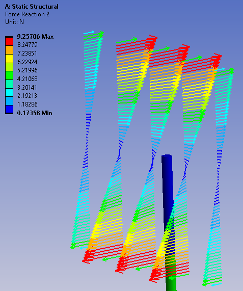

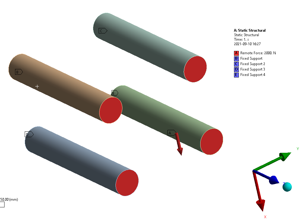

SubscriberPlease observe the pictures below.
MODEL [remote force is in the center but a few mm forward in the z direction]:
September 13, 2021 at 7:15 amRameez_ul_Haq
Subscriber,can you please comment about this? :)
September 13, 2021 at 8:55 pmpeteroznewman
SubscriberYou didn't mention if the Remote Force had the behavior set to Deformable or Rigid.
First question, why do the force vectors go in two directions? Because the beams are shearing and bending and the top is in tension while the bottom of the beam is in compression. You seem to call the four rods a "beam". If you had a long solid beam with a tip force, the material above the neutral axis would be only in tension. But you have a short beam made up of four rods, so they behave differently than what you were expecting.
Second question. Nodal forces depend on the mesh. If you have a cross-sectional area and fill that with 8 nodes, the forces will be very high compared with the same area filled with 80 nodes. You don't use the maximum nodal force to size the beam. The resultant force tells you the shear force and axial force. Knowing these values you can select a cross-sectional area that keeps the stress below yield by a large Factor of Safety.
Third question. The applied force has no Y component so there is no Y component in the Reaction Force. There is nothing to consider when sizing the beam in the Y direction.

To be honest, I couldn't actually understand your answer about the first question I asked. Lets just call each of the 4 solid cylinders in my model as a rod. Now, shouldn't the rod that I have picked in my second picture only be in tension? I mean you are right that I was trying to make ANSYS believe that these 4 rods actually belongs to a single structure. But I think since I didn't do this, thats why I am seeing both tension and compression in the rod of concern. This makes me believe that each rod has an individual neutral axis and the overall neutral axis of the whole model is not even considered by ANSYS. Am I right? If yes, then what can be done to make the ANSYS believe that these 4 rods belong to a single structure, and a general overall neutral axis should be taken into account.
Plus, if ANSYS considers individual neutral axis for each of the rod, then why do I see a net force in the Z axis for the concerned rod when there isn't any external force applied in the Z axis? I mean shouldn't there be only a net moment in the second and third picture, but no net reaction force in the Z axis? Isn't it?
Your answer to my second question is also a little bit baffling. I mean you thaught me that the mesh size doesn't matter to calculate the total amount of force passing through a rod or a cross section of a body. It all depends upon the general equilibrium of the body that how much force is passing through a cross section of a body. We can use Rigid Dynamics for that directly as well, where meshing doesn't even play a role. Mesh is only required to calculate the displacements and stresses in the structure within a certain accuracy. But now you are saying that the the net nodal forces in a cross section depend upon how many nodes I have in a cross section. Confused ! This discussion also hits my brain with another question. Like if only resultant shear and axial forces should be used, then why do we have a stress calculation equation which depends on bending moment only. Since in a bending due to transverse loading case, there won't be any net resultant axial force in a cross section but a bending moment will exist. So the question actually becomes when should the bending moment be used, and when should the net resultant axial force be used? (For a cross section of a rod or any other body).
Regarding your last paragraph, I would like to ask something. I mean at the fixed support locations, we know that the ANSYS is applying a Y axis reaction force there to keep those faces not displace in the Y direction (Poisson's ratio effect). However, since there isn't any external Y force, the net resultant Y force at these fixed faces should be zero. We know this. But these forces are being applied, and causing extra stresses near these fixed supports, so this means that it should play a role in sizing of the beams. Maybe by using a torque about Z axis, or maybe not. Or maybe something esle. I don't know. Can you please say something about this?

SubscriberDeformable vs Rigid Remote Force can make a large difference because Deformable adds no stiffness to the structure while Rigid adds stiffness to the structure! In this example, deformable behavior allows the end faces of the rods to individually rotate while bending. Rigid behavior enforces the end faces of the rods to rotate as a rigidly connected group. I suggest you run the model both ways and look for the difference.
First question. A neutral axis is a concept used in the formulation of beam elements. A solid mesh does not have a neutral axis included in the formulation. Try to build the four rods from beam elements and see what you get. The forces in the solid rod elements make sense to me. Maybe when you flip the behavior of the remote force, you will get a different result that makes sense to you.
Second question. It is correct that the total force through a cross-section is independent of the mesh. I never said "the net nodal forces in a cross section depend upon how many nodes I have in a cross section". You asked "how can I find the maximum force (among all the nodes) at a specific cross section". I took that to mean you were asking about individual nodal forces and replied that you don't care about nodal forces because they depend on the mesh.
Bending moments apply to beam elements. There is no such thing for solid elements, which only know about forces. You can infer that the net resultant of the forces applied to the face of a solid mesh imply that a moment is being applied to that face.

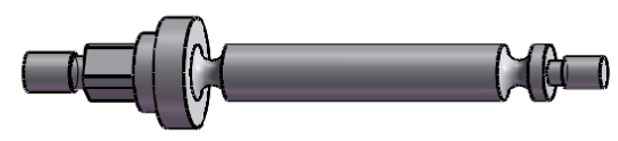

Last paragraph. You design the area around a fixed support to avoid the stress created by Poisson's ratio by simply flaring out the material to a larger cross-sectional area. Below is an image of a rod flexure that illustrates this point.

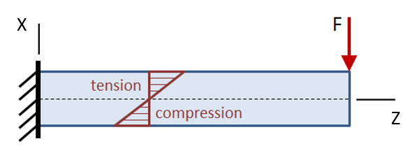

Below is a textbook image of the forces in a cantilever beam. The applied force is in the X direction, yet all the internal forces are in the Z direction.
Here is the Ansys Force Reaction plot. That is why I say the forces in the solid rod make sense to me.

Subscriber"How would I know how much bigger area should be used near the cross section and when should this enlargement of the cross section area begin (I mean at which length)."
You would start with an initial design concept, such as the rod flexure example I provided above, build a FEM of the initial design, look at the results and come up a list of changes that become the first design iteration. Update the FEM, look at the results, come up with more changes that become the second design iteration. Continue iterating until the design meets all the requirements, or is optimized for some metric such as minimum mass. The iterations can be manual or you can use some of the tools Ansys provides to automate the iteration.

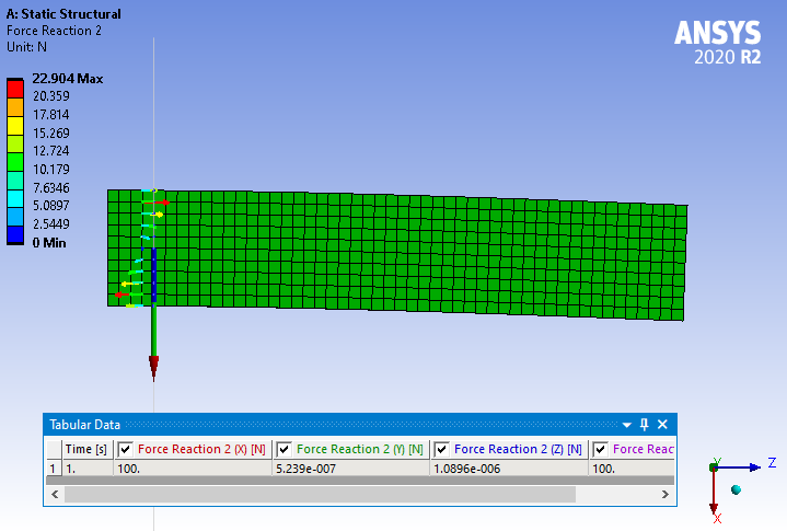

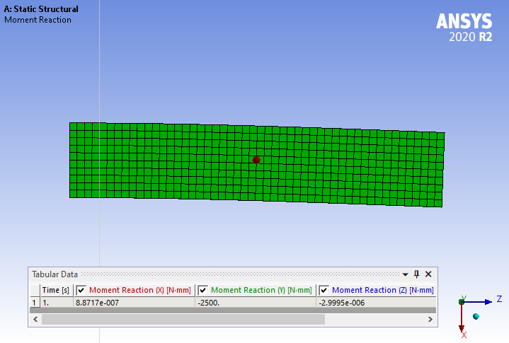

SubscriberAs expected, there is no net force along the Z axis. If you slice this beam in half horizontally so there is an upper and lower member, obviously, the upper member (or rod) will have a net force in Z and the lower member will have the opposite net force in Z.
There is a Net Moment about Y.
The image below is the same model but meshed with 100 elements through the X direction thickness. Note that the maximum nodal force is much smaller than the coarse mesh above, 9.2 N instead of 22.9 N, which illustrates what I said above about how maximum nodal force (not net for the section, but individual nodes) depends on the mesh.
