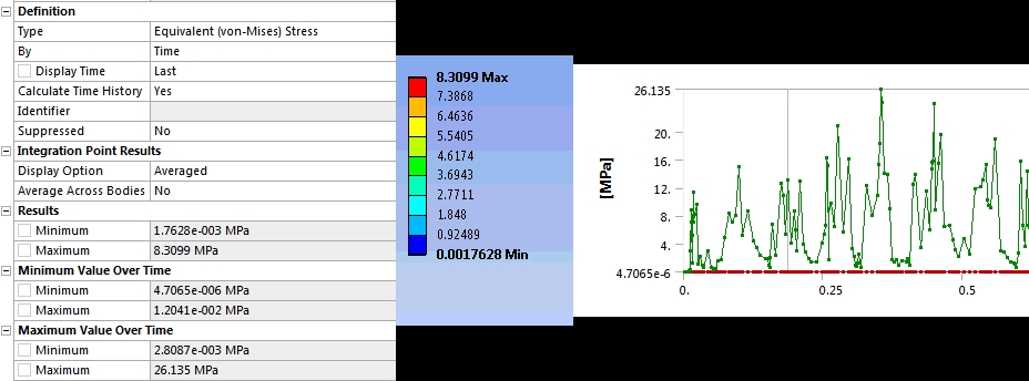

      Can anybody tell me why the Max value on color scale is shown as 8.3 rather than 26.1 as seen in graph?
      Also, this 8.3 is written as max under "Results". So what is the difference between this max value and other max value over time? Is it the average or something else?
      Thanks.
      There are two things over which to take a maximum, space and time. Results Maximum is over space at the end time.
      The last value on the time plot is 8.3 at the end time.
      The Maximum Value Over Time is 26.1 MPa which occurs at about t=0.33 and is also the maximum over space.

    • Naveed
      Thanks brother, accurate!
