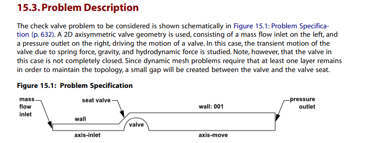

Ansys EmployeeThere is one example for Store Separation using overset and SixDOF solver (you can ignore the overset aspect of the model but learn from the SixDOF section).
Chapter 15: Using Overset and Dynamic Meshes
