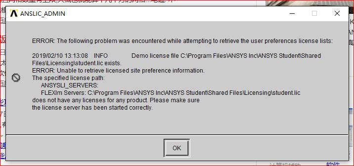

February 10, 2019 at 6:10 am
dytian7678
Subscriber -
February 11, 2019 at 9:49 pm
tsiriaks
Ansys EmployeeHi dytian7678,
Please post your question in one place.
Let's work on your issue on this thread
/forum/forums/topic/ansysli-error/
Thanks,
Win
