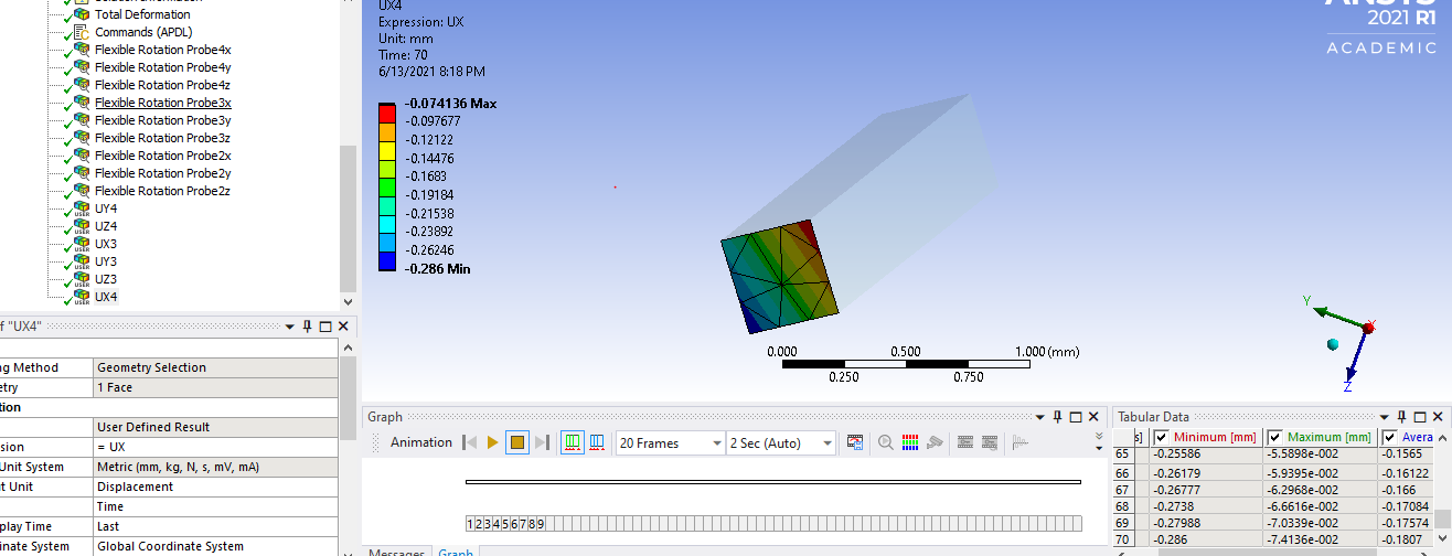

If I apply a remote displacement on a face with translational and rotational displacements, and then measure the translational displacements of the face (UX, UY, UZ), I don't get the same values as those I applied as boundary conditions.

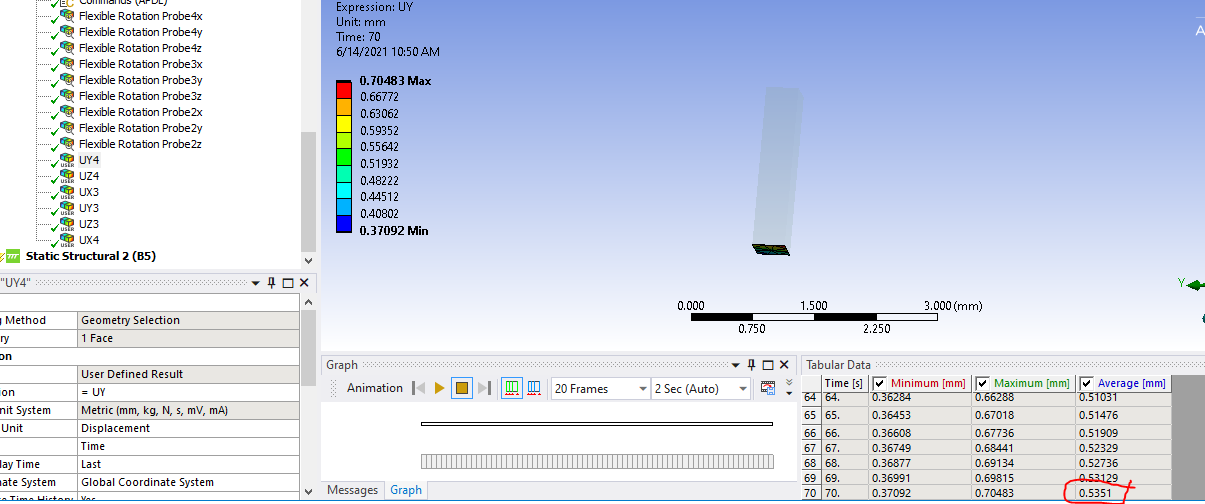

SubscriberActually I tried setting it to rigid, and applied a certain rotational angle, the body didn't even rotate.
On the other hand, I don't think it's something related to the tolerance, here's why:
as you see, the applied displacement along y is -0.14mm at step 70 for example. When measuring UY on this face, here's what I get: (0.53 mm!!)

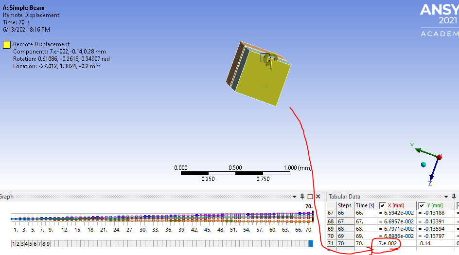

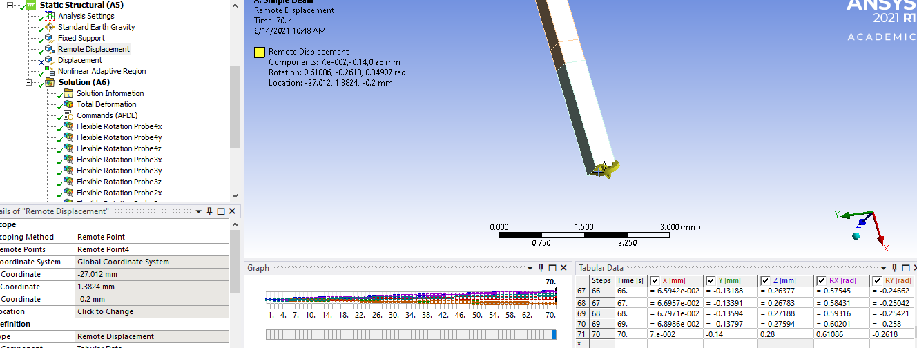

June 14, 2021 at 8:59 amZainaba98
SubscriberIn fact, my problem is that on this very face I need to apply a translational displacement of (x = 7e-2, y= -0.14, z=0.28) and a rotational one too. For this I used a remote displacement, however am not sure anymore that am really applying these boundary conditions (regarding the values am getting when measuring UX, UY,UZ) on this face
