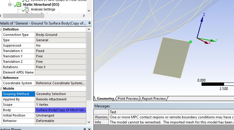

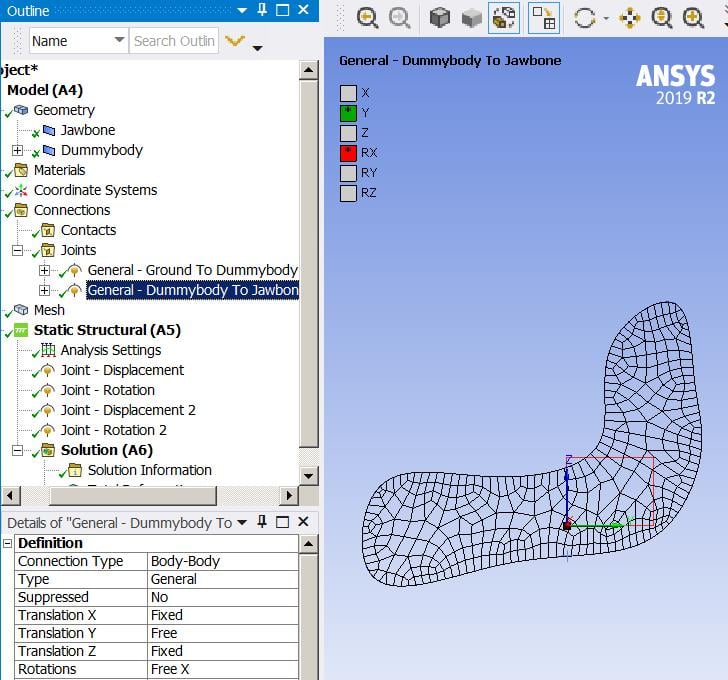

      Here is one solution, use a dummy body, put one General Joint between ground and the dummy body for making the first translation/rotation, put a second General Joint between the dummy body and the jawbone.

      in the details of the general joint there are a lot of settings. I've attached the image just to better understand...
      So:
      -free means that the body is able to move or rotates along that direction or around that axis, is it right?
      -the coordinate system is not the global coordinate system of my jaw, I'm not able to change it..
      -apply by remote attachement or direct?
      -regarding the body to be attached I should consider once the dumy body and then the teeth of mandible, is it right?
      -initial position unchanged?
      -stops what does it mean?
      Sorry for all these questions, but I hope to receive an answear..what about the remote displacement that I felt more confident about? there is no way to use that command?
      Thank you very much!
      Best regards
      details of the general joint tool
      -Please could you clear me what you mean by dummy body?
      You need to cascade two motions. This is accomplished by having an extra body that is present so that the first motion is applied between ground and the dummy body, which carries the jawbone with it for the ride. Then the displacements of the first joint remain constant during the second step when the second joint between the dummy body and the jawbone moves.
      -is it a rectangle where two corners are my two points around which rotation occurs?  Yes.
      Yes, and we move it with the joint load.
      Expand the + sign under the joint, you will find the joint coordinate system, you can alter the orientation of that.
      -apply by remote attachment or direct?  Remote Attachment, read the ANSYS Help for details.
      -regarding the body to be attached I should consider once the dummy body and then the teeth of mandible, is it right?
      I made the dummy body rigid, you I can just pick a vertex. On the mandible, pick a few faces near the point on the rigid body.
      -initial position unchanged?  Yes.
      If you leave a joint DOF Free, you can limit the range of motion. You don't need that because you are specifying the motion of the free DOF in a Joint Load.
      -what about the remote displacement that I felt more confident about? there is no way to use that command?
      Not that I have been able to figure out.

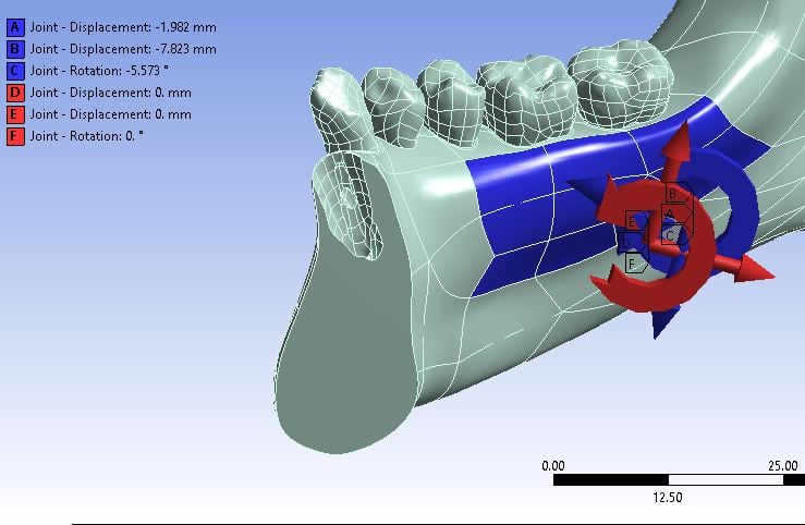

      - the first issue involves the construction of the rectangle.. I defined the two points but I didn't manage to create a rectangle by overlapping on the two edges, however I tried to be the more precise as possible to move my rectangle over those points. Then I've created a surface from that sketch and given a minimum thickness otherwise problems occurred. Do you think in this way it can be feasible? How should I have done in the right way?

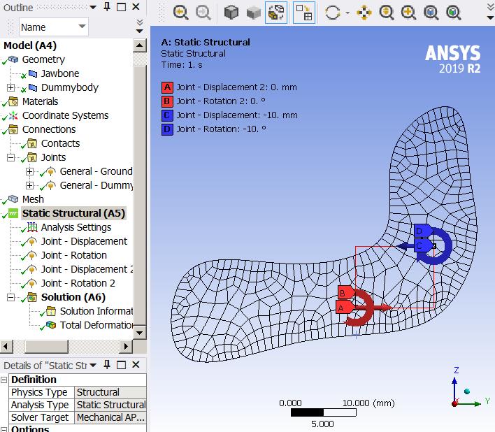

      - Regarding the rototranslations I've specified in the connections the axes along which to move and the rotational axis, however as you can see from the picture it seems that only the first rototranslation occurs..why are the value of D,E and F 0? I noticed that you too got the same result. Moreover I had to define a translation at a time infact I have 6 "joint" in the analysis settings and I set the values of the second rototranslation as second step of course, right?
      -to achieve convergence I had to switch to large deflection maybe because the mandible is flexible (since I need the symmetry condition). is this an error?
      -To conclude the tabular data near the graph of the total deformation show three columns minimum , maximum and average, what do they mean? is that the minimum, maximum and average displacement? if yes, according to which reference system have they been computed? because to define the two general joints I set two coordinate system over the vertices of the rectangle which are oriented according to the my global reference system.
      The dummy body can be any size, and it shall be rigid. It can be any thickness (as long as you don't have gravity as a load). The two joints attach to this dummy body at a coordinate system. You are free to put the origin of these coordinate systems anywhere. If you orient the joint so an axis lies along the direction of the x and y translation components, then you can just translate along that one direction by the total length of the x and y components.
      For time step 1, you have some values for translation and rotation of joint 1 and joint 2 is set to zero.  For time step 2, the values of joint 1 remain constant (are the same as time step 1), while the values for joint 2 become non-zero in time step 2.
      Yes, that is a required setting.
      They mean exactly what they are. If you have an edge or a body, then those three values will be different, but if you have a vertex, then those three values will be identical. For example, if you were to plot directional deformation of a body in the Y direction, and the top of the body moves -2 mm while the bottom of the body moves -8 mm then the maximum value would be -2 and the minimum value would be -8 and the average value would be between them.

      Just to be sure.. The dummy body can be any size as you said and it is related to the joint through the coordinate system which in turns can have the origin elsewhere even outside the dummy body, as in the picture, right? Then by selecting a vertex or face or edge as a scope to the dummy body everyting becomes connected, right?
      Moreover this rototranslations are simultaneous? I mean rotation and traslation occur together or there is first a rotation and then a translation?

      The dummy body can be any size... ...can have the origin elsewhere even outside the dummy body?  Yes.
      Then by selecting a vertex or face or edge as a scope to the dummy body everything becomes connected, right?  Yes
      Moreover this rototranslations are simultaneous?  Yes.
      I have used the APDL command D, node, %_FIX% in the case where in Step 1, I apply a Force and don't know what the final displacement of object 1 will be, then in Step 2, I want to hold object 1 fixed at whatever value of displacement it ended at step 1 to begin a step 2 load on some other object.
      I couldn't imagine how to use this method in your case because you don't want the first object fixed during step 2, you actually want it to move as another object is given a displacement. That is why I thought to use a dummy body and cascaded joints. It makes the problem somewhat simple.
