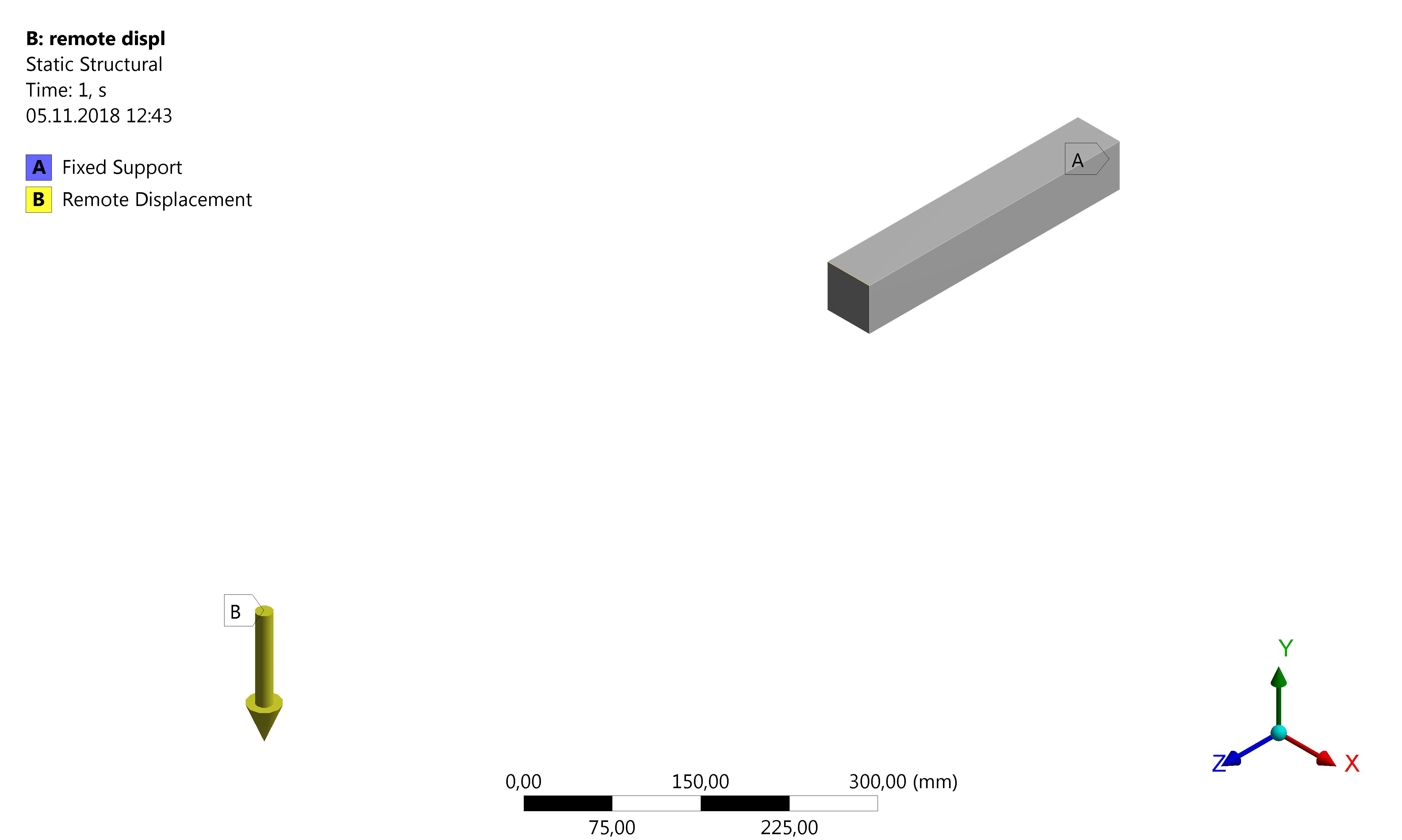

      Based on previous discussions (e.g. this), I implement a displacement on the edge of the beam
      1
      and then I shorten the beam length(less elements) to apply a remote displacement:
      2
      with details like:
      3

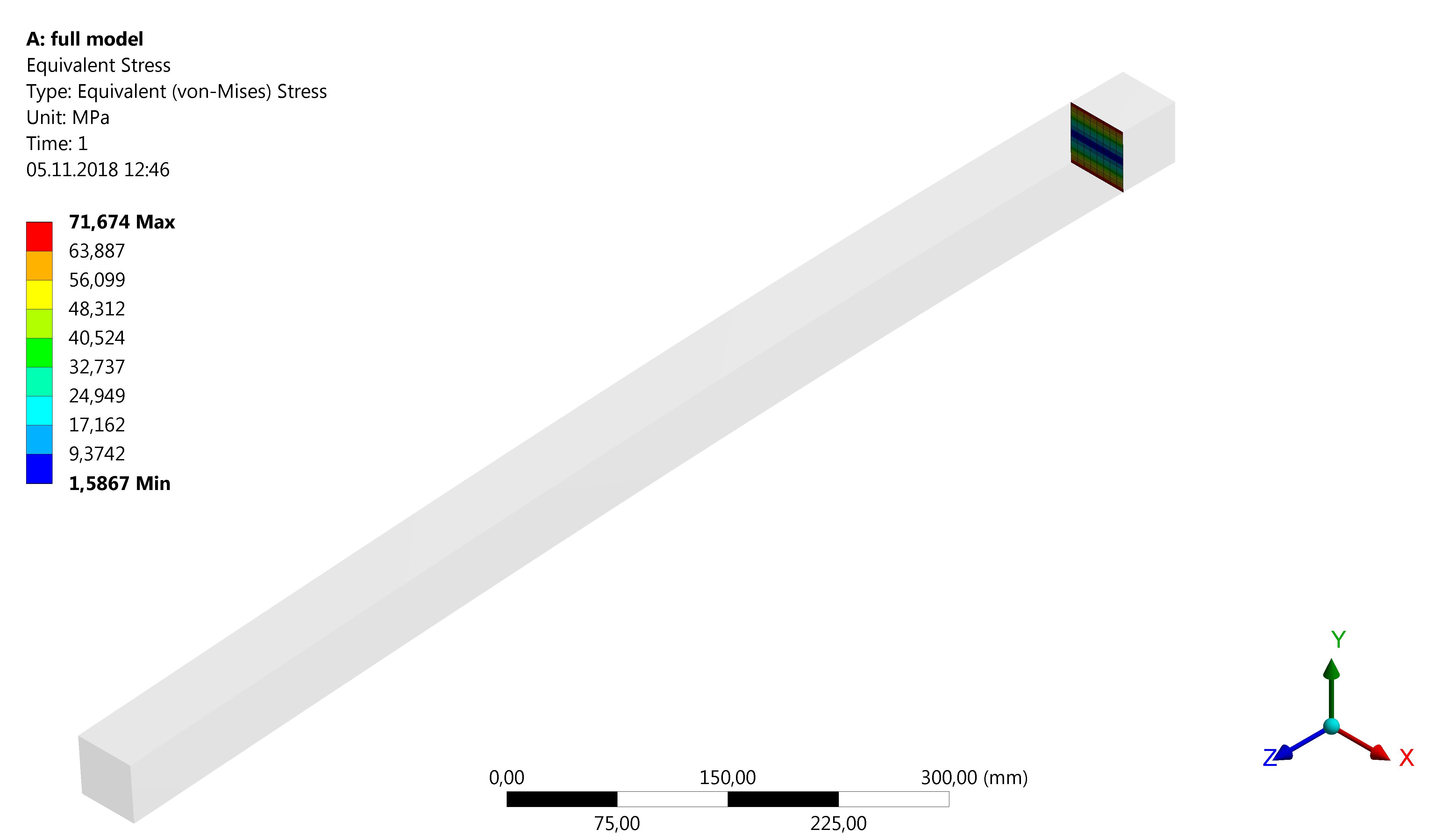

      From this I should expect same results right? But they are not the same (displacement as well):
      4
      5
      Did I do something wrong?
      attached is also the file.
      You need all rotations set to 0 as well as all displacements on the Remote displacement in order to have a static solution. The advantage of a Remote Displacement over a Fixed Support is you can configure the RD to have a Behavior set to Deformable instead of Rigid. Rigid would give you results similar to a Fixed Support.n

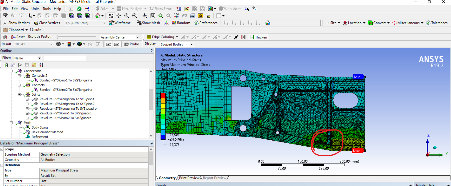

      Yes, thank you.n In the remote displacement i set all the things to 0 as you said but the max continues to appear to be on the corner as shown but it is supposed to be in the area inside the red circle any idea why?nn
