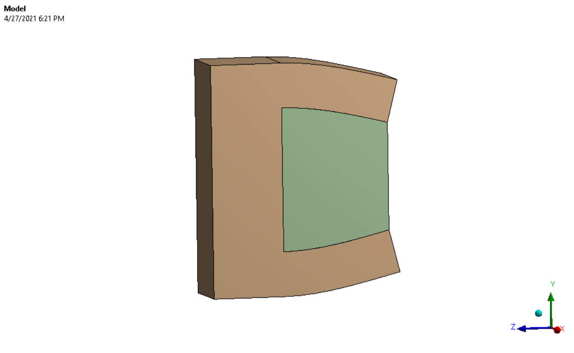

SubscriberI am trying to model the stress distribution within collagen (green part in the picture) that polymerize inside cantilever beams (brown parts in the picture). I am using Neo-Hookian material model for the collagen and the elastic material model for the cantilevers. The initial state of the system is shown in the picture, i.e. the cantilevers are bent and kept in this state via a simple gadget. However, as the gadget is removed, the cantilevers return to the straight position as the result of releasing the stored strain energy (no external force). I want to study the stress distribution within the collagen while the cantilevers are travelling from bent position to the straight position.
Is there any way that I can define this initial condition of the system in Workbench ? I do not want to apply any external displacement on the cantilevers (e.g. tensile displacement on the free end of the cantilevers), rather, I prefer to model the release of energy when the cantilevers are returning to the straight position and study the stress distribution in the collagen during such displacement. Is there any work and energy analysis in Workbench ?

SubscriberThanks for your comment. I will try what you suggested. However, the challenge is that although the cantilevers (brown in the picture) are pre-strained, the collagen (green part in the picture) is not pre-strained, because it forms/polymerize within the space between the already-bent cantilevers. Since it is attached to the walls of the cantilevers, it is pulled along with them once they are released. So, If I apply bending on the cantilevers in the first step, it means that I am introducing pre-stress to the collagen which does not reflect the loading condition in reality.

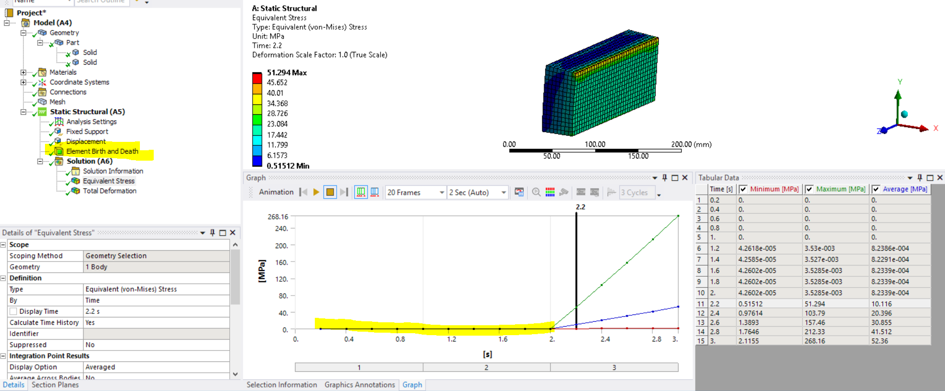

Ansys EmployeeWe can use the element birth and death, and deactivate the collagen in the first step.
So we can have two or three steps:
Deactivate the collagen part, and deform the cantilever.
Activate the collagen, and hold the deformation.
Bring the cantilevers back to original position (or just deactivate the enforced displacement), and see how the collagen develops stresses.
To apply a Element Birth and Death condition:
On the Environment Context tab: click Conditions>Element Birth and Death. Or, right-click the Environment tree object or within the Geometry window and select Insert>Element Birth and Death.
(For more info on activating and deactivating elements/part see help manual.
Once done it should look a bit like this (this is just for reference as it is an arbitrary example for illustration only), where there is no stress in the activated part (though element birth) for the 2 first steps, and then stress develops gradually as we bring/pull the structure back in the last step.

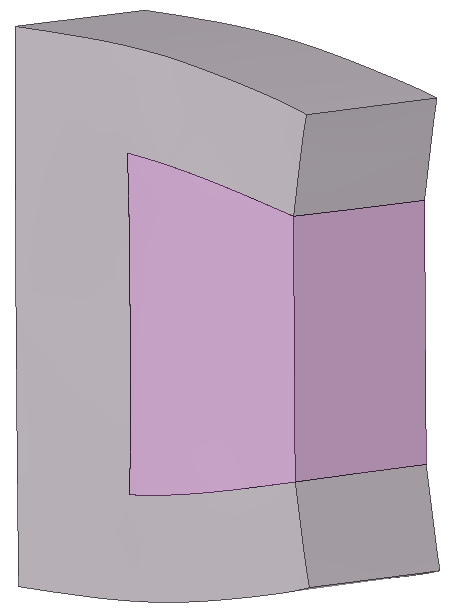

SubscriberThank you very much. Attached, please find the file as instructed. Meshes and the solutions are cleared. Yet, the vertical displacements of the legts (in Z direction) and the frictionless support of the wall are still there. As for the shape of the collagen, I would want it fill out the space between the bent leges of the frame. So it should have two vertical planes on left and right (one side attached to the frame and the other side being free), and two bent planes on the top and bottom which are attached to the bent legs.

SubscriberI used the method described by here: /forum/discussion/233/how-do-i-get-deformed-geometry/p1
In Geometry cell C2, I export a Parasolid file, which I import into Geometry cell D2.
In Geometry cell D2 I created the collagen between the bent arms using SpaceClaim.
