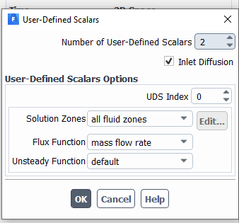

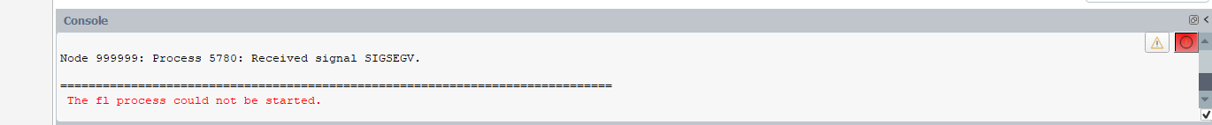

      When i try to compile, the console shows this error and the fluent window stopped working. I am allocating 2 memory location for UDM.
    • DrAmine
      Look carefully into the lines where you want to access the previous time step results..

      And ensure you are defining two UDS's.
    • ritwik
      Yes i am defing two UDS

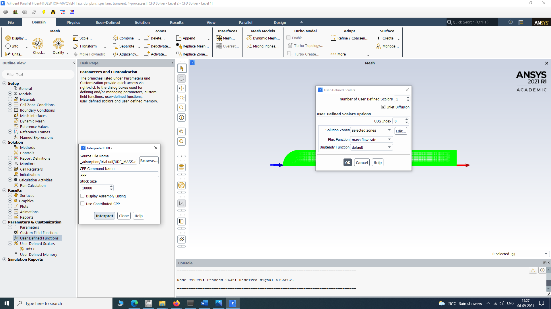

      You've not defined a few of the variables (REAL, INTEGER etc) and I wonder if using a comma is permitted in C, you might need a full stop for a decimal. As you're using 2021 compile the code with the built in compiler: if nothing else it'll give us a better idea if the code is OK.
    • DrAmine
      Again your UDS and index. Check what Fluent reports when compiling.

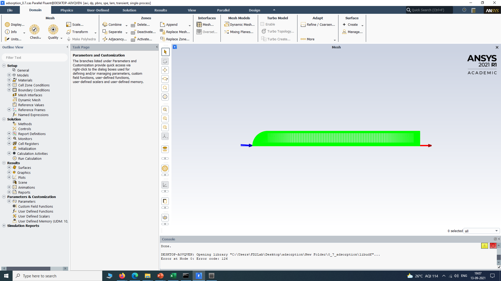

      when i tried to compile the udf

      this error is showing.
      Can you please help me? What is this error meant?
