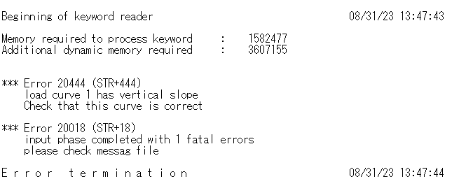

    • 広典 小松
      I would like to know how to improve this error.
    • armin.abedini
      Hello there,
      Please check your curve ID 1 (look for DEFINE_CURVE keyword in your input file). There might be some points that are repeated that create this error. Also, make sure that for each x-value, only one y-value is defined.
