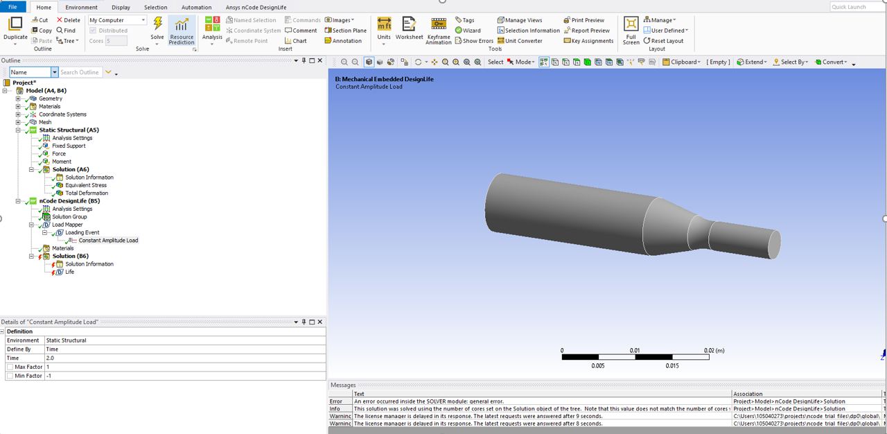

reg -Solver module general error during executing stress lift in nCode 2021R2
    • senthil.v
      When the simple model simulated for fatigue life study in Ansys mechanical and subsquently in nCode Design life in Ansys 2021R2. The material used is Structural steel. The analysis is solved in Ansys mechanical ,but when the results are exported to nCode, the solution shows solver error. solution sought to overcome this error
    • Manish Dubey
      Hi Senthilkumar,
      Does this appears on this model only or all other model. If it appears on all other model, then it indicates that the results are not saved locally and may be Add-on cannot find them. Solve the Mechanical in the background and solve Design Life locally.
