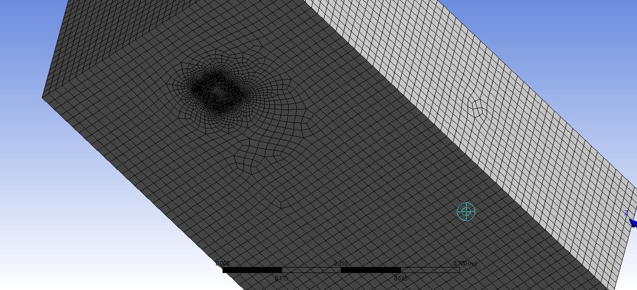

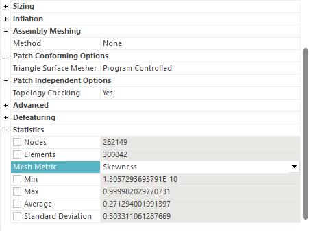

I am doing a project where I need to simulate natural ventilation for an isolated generic building. When it comes to meshing, The skewnes is very high that is 0.9999+.Â
And this is the meshing.
I used the hex dominant method as my supervisor said it will be much better for a cube shape building. However, i cannot reduce the skewness of the mesh. I am very new to this software, and I am trying to learn it in any possible way. Thank you in advance.

Subscriber Skewness can be improved by editing the geometry in two ways:
1) Remove small details from the geometry that are unimportant to the simulation. This will allow the mesher to use larger elements.
2) Slice the geometry into pieces that are easier to mesh. The pieces have to be put into a Multibody part so the mesh reconnects the pieces.

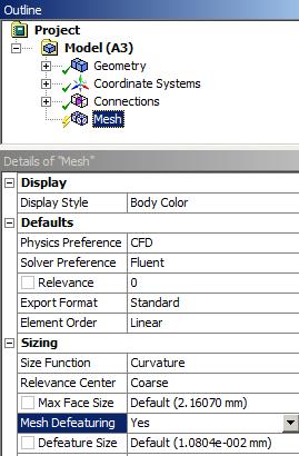

There are some mesh settings that allow mesh quality to be improved. One is the Mesh Defeaturing setting. That is like #1 above, but without doing any actual work on the geometry. That is found under Mesh Details. The mesher chooses to ignore small features and bridges elements right over them.
There is a feature called Virtual Topology that can be applied that automatically selects multiple small faces of the solid and replaces them with one larger face. Right click on Model and Insert Virtual Topology.

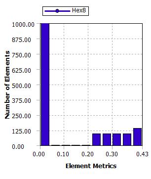

I suggest you idealize and simplify the problem somewhat and use a zero thickness surface for the "building". That is as simple as adding a MidSurface feature on the solid building. I also suppressed the extrusions that make up the block of air and the cut body operation. Instead I use an Enclosure. The solid and surface body are put into the same part using Form New Part.
Then you will have one solid with a zero thickness walled building to mesh.
The next thing I did was to create 5 planes, one on each face of the midsufaced building, and Slice the air up using those 5 planes. Select all the solid pieces and Form New Part to have the mesher connect them together. These solids are all put in a Multizone control to be meshed with hex elements. Here is the skewness report.
I have not added any mesh refinement yet, that still needs to be done to get many elements around the windows and over the building.

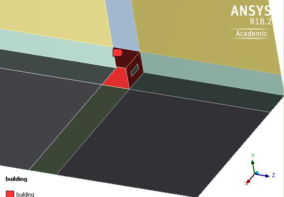

I did 10 planes and 10 slices like you said. After that, I proceed with the mesh by using hex dominant method. Please correct me if I'm wrong. I tried to named the surface like inlet, outlet, walls and the building. However, when I tried to create named selection for the building, I can't seem to select the outer surface of the building. Here is the new mesh only archive attached.Â
May 18, 2018 at 8:28 pm
peteroznewman
SubscriberHere is a video on how to select the faces of the building walls. I forgot to mention to suppress the contacts in the Connections folder. In another video I will cover inflation.
https://youtu.be/OO66jR8UBZM
