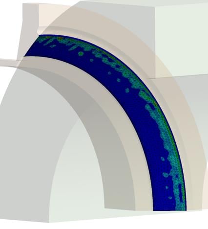

      I'm having issues making the simulation to converge. Force is applied on the seal. The force goes through the support, spring, seat to ball.
      While the force is applied, Pressure on the following area is also applied.
      I'm studying the contact pressure between the seat and ball at 3 different forces and pressures.
      The simulation converged after I added stabilization controls, but it make the simulation slower.
      This is the results after force and pressure are applied. The spring is deformed and pushed completely against the seat.
      Two questions:
      1. I read that the stabilization add dampers. How can I check how those this influence on the result accuracy?
      2. How can I reduce the simulation time, without affecting the result accuracy?
      I will appreciate any advice.
      Thanks

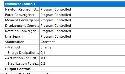

      About the stabilization controls. I used the following settings on some of the steps
      I read on Ansys help that the stabilization energy should be less than 10% of the strain energy. Is that the only thing I should check to confirm that the stabilization controls are not affecting the accuracy of the results?

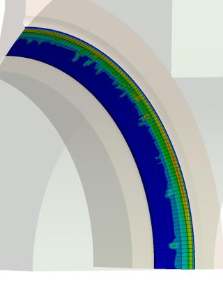

      I forgot to mention that the model is not symmetric. There are some waviness around the ball.  That's why the contact pressure is different along contact surface between the ball and seat.

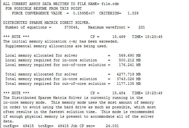

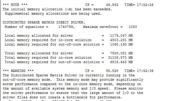

      You can check if the computer has enough memory (RAM) to solve incore. That means without using disk storage. You can see that in the Solution Output when the Direct Solver is used. Search for the word memory and look for incore or out-of-core.  If the solver is running out-of-core, you can reduce the computation time by installing more memory in the computer.

      I have checked if my computer has enough RAM. It seems the solver is running out-of-core. So according to the picture below the amount of memory required for run in core is 3818.18 MB and I have 32G RAM memory. Shouldn't that been enough to run in core?, also do you know why is the allocated memory so little?
      I will be able to increase the memory up to 64GB, Do you think that will reduce significantly the computational time?
      Thanks!
      Hi Josi,
      This model is running in-core, which is the fastest.
      If you refine the mesh and it starts running out-of-core, try restarting your computer, open Workbench and Update the Project. The memory may have been chopped up by other programs and a restart gives you the largest contiguous block of RAM possible.
      If you find you frequently have models that run out-of-core, then you should upgrade to 64 GB of RAM. My policy is to install as much RAM as the motherboard can use.

      I re-started the computer and run the simulation again but similar values of memory are shown.
      The command to force to solve in-core is DSPOPTION,,INCORE  and it should be added under the solution tree and that should be all I need to add right? sorry,  I have never used  the APDL command before. Do you recommend any tutorial to start with the most common commands.

      Josi,
      The first NOTE lists the memory requirements for both modes.
      Read the second NOTE, it says the solver is currently running in the in-core memory mode.
      You have found the right command, but the solver has already selected in-core, so there is no need for this command.
    • JosiSandoval
      I see now. So having more memory it won't make it faster anyways.

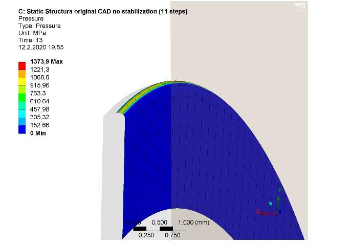

    • JosiSandoval

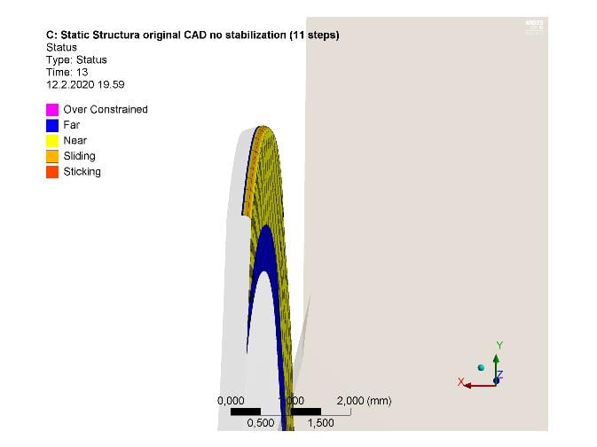

      I have another question.. let me know if I should create a new discussion

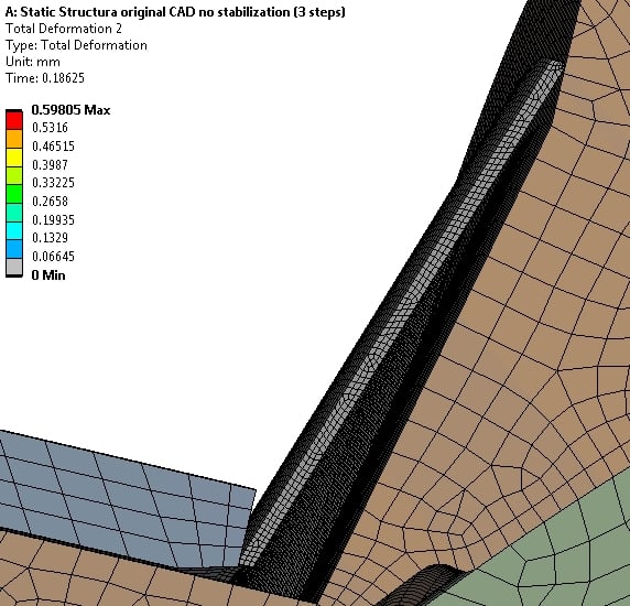

      the following image is the initial contact of these two parts.
      At the end of the simulation it seems there is no contact between those two faces.
      But when I look in to the contact tool for the contact status and pressure, it shows that there seem to be contact
      I see the same behavior in the these other two parts that were in contact at the beginning but at the end of the simulation there is a gap
      but the contact tool shows that there is still contact between the parts
      I don't understand why is this happening, is there actually a gap or there is some error with the graphics of my pc.
      Thanks again!
      There is a Display Scale Factor called Result that you must set to 1.0 (True Scale) to see true displacements on the screen.

      I have True scale selected. That's why I wonder why I see this results. Should I trust on the tool contact results?

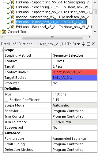

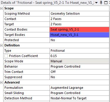

      Did you use Adjust to Touch on some of those contacts?
    • JosiSandoval
      No, I used Add Offset, Ramped Effects in both cases. The initial contact information for the first contact shows that they are near-open, but for the second contact (last two images from above) there is initial contact.
      Here is the file in case you have time to give a look

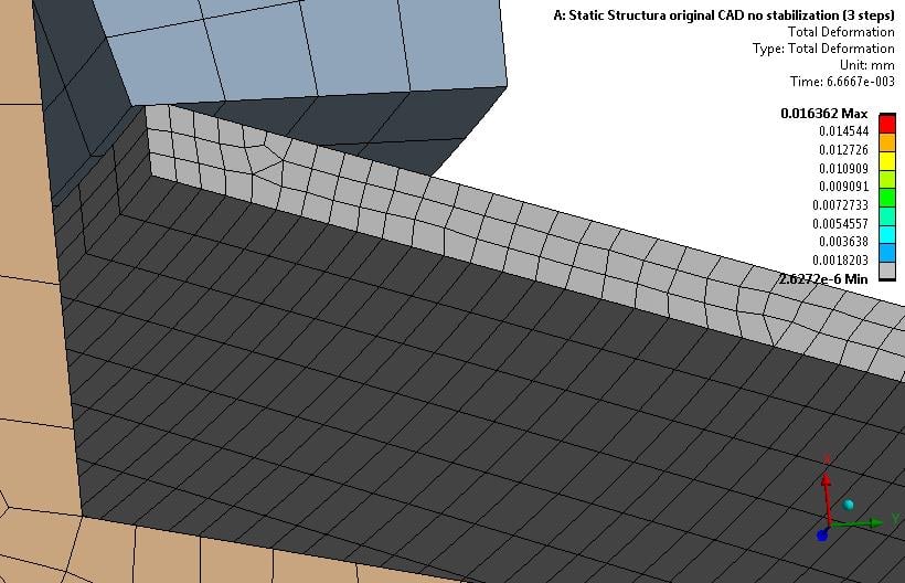

      Why do you have Cylindrical Support 2?

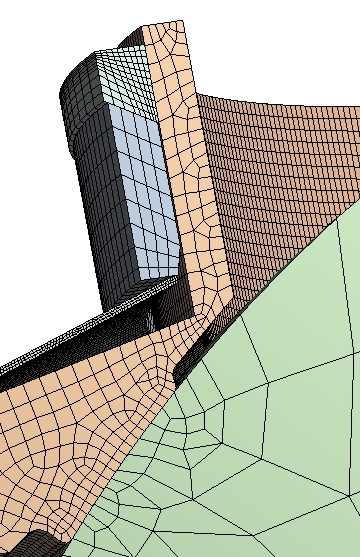

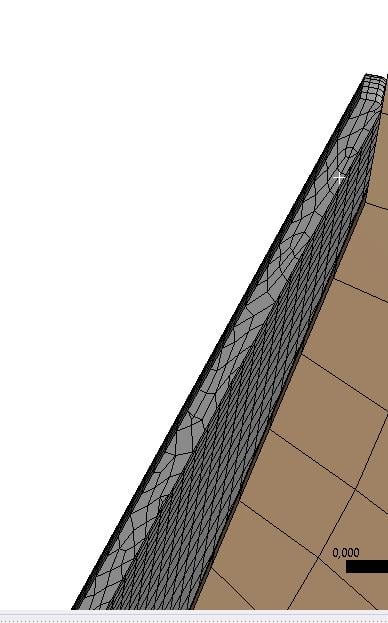

      I recommend you have at least two elements through the thickness of the Seat spring.
      Under Analysis Settings, set Large Deflection to On.
      I updated the contact to have a different Detection Method.
      Here are more elements through the thickness.

      I am running it now with Large Deflection On and the cylindrical support 2 suppressed. It got about 14% of the way into Step 1 then started to bisect. I stopped the solver and refined the mesh on the HSeat_new and restarted the analysis.
      I think the display incongruity you saw was due to not having Large Deflection On.

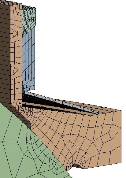

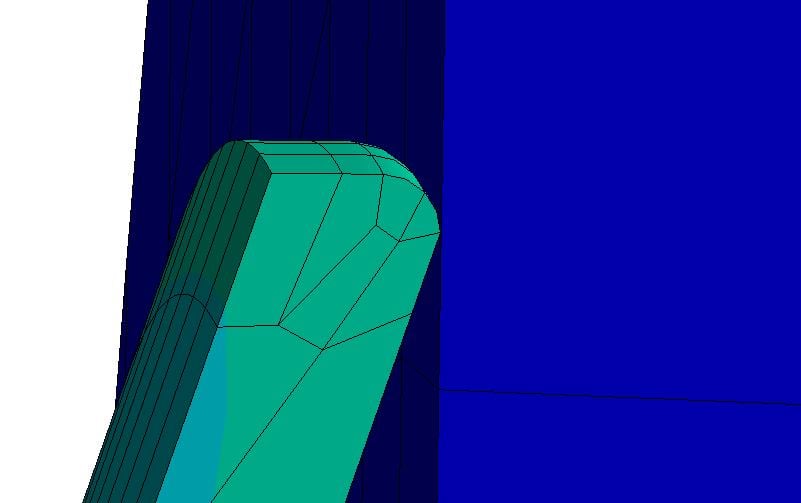

      Can you please tell me which refinements you applied on the HSeat and also on the seat spring?
      I'm struggling to make it look like the photo you sent. I'm adding edge sizing to add more elements through the thickness but so far it looks like this.
      Thanks a lot

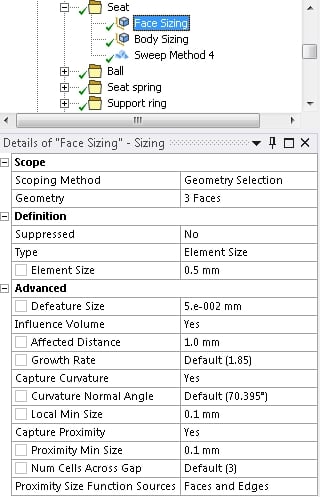

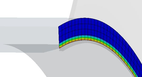

      I suppressed some of your mesh control, changed the Edge Sizing to 5 and added a Face Sizing 3
      After it failed to converge at 14% I changed the Seat Face to this mesh.
      I also flipped the Contact.
      The solution progressed to 18.6% of the first step load in 11 hours on 15 cores,

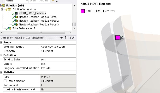

      But it stopped with an "Element violation" error.  Are you using the automation to create these Element violations under the Solution Information folder?
      The corrective action is to make smaller elements on the Back seal part and rerun the analysis.
      I also question why is the Back seal, which is 50 times more flexible than steel, bonded to the steel Support ring?  Is that the real condition, or is it more accurate to model that as a Frictional contact?
      I haven't looked for where the geometry is not axisymmetric, but an axisymmetric model would run at least 10 times faster.

      Yes you are right it is more accurately to use frictional contact.

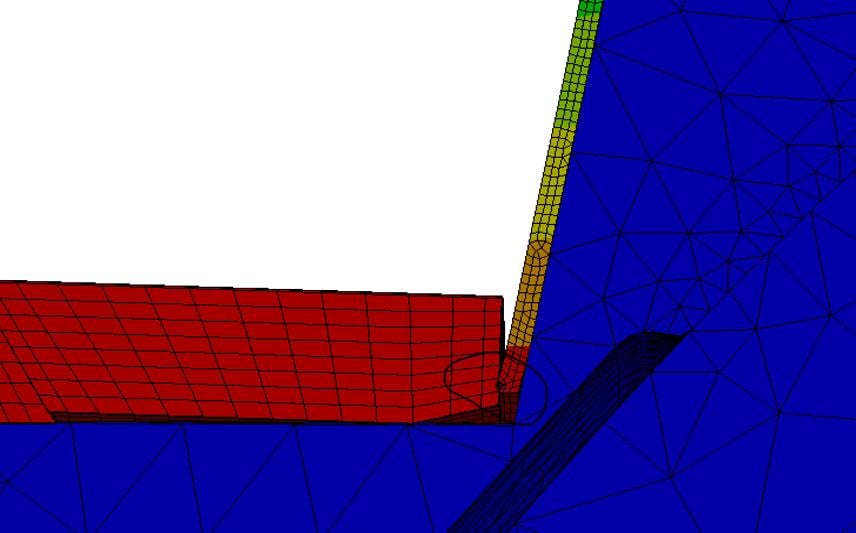

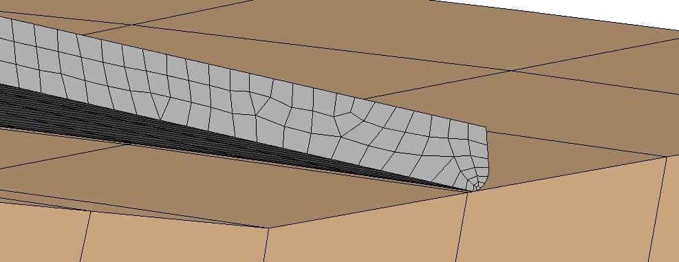

      With the Back seal contact with the Support ring changed to Frictional, and a better mesh shape, the solver got 19% of the pressure load applied in step 1 before an error occurred. This took 14.5 hours on 8 cores and went for 506 iterations.  The error was a contact suddenly changed state and the model had an internal solution magnitude error.
      Here is the first substep.
      Here is the last converged substep.
      I think the reason the solution blows up after this is because there is a sharp corner on the seat spring trying to slide off the sharp corner of the support ring. The corrective action is to put a small radius on both corners so the radiused corners can smooth the transition that is being approached.

      Yes I have seen the error due to contact suddenly changed state before, that's why I add the cylindrical support 2. I will modify the sharp corner.

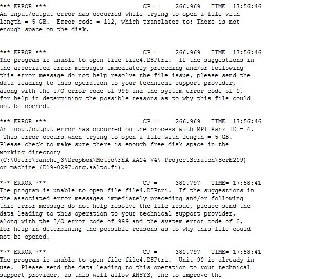

      Also I try to run the simulation improving the mesh shape, with the backseal- Support ring contact changed to Frictional and large deformation on, but got the following error
      t
      could it be because I'm running out of cores
    • JosiSandoval
      I re-started it and I didn't see that error again.
      It looks like you ran out of disk space.  Make sure you have hundreds of GB of free disk space before you start a solve.
