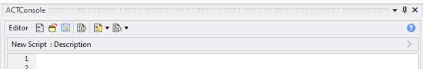

Ansys EmployeeThe Record tab in Mechanical is avaialble under Automation > Mechanical > Scripting after the version 2021R1. Which versionare you using? Could you please share the documentation chapter you are referring to?
February 13, 2024 at 2:12 am
helen.durand
SubscriberThank you for the reply.
The documentation for 2024R1 contains the record button: https://ansyshelp.ansys.com/account/secured?returnurl=/Views/Secured/corp/v241/en/act_script/mech_script_view.html
I am using ANSYS 2020R1, so I am assuming the record button is not included in this version.
February 13, 2024 at 11:25 am
Zoi Stavrothanasi
Ansys EmployeeHello Helen,
That's correct it is not included in your version! This feature is added on 2021R1.Â
Hope this helps!
