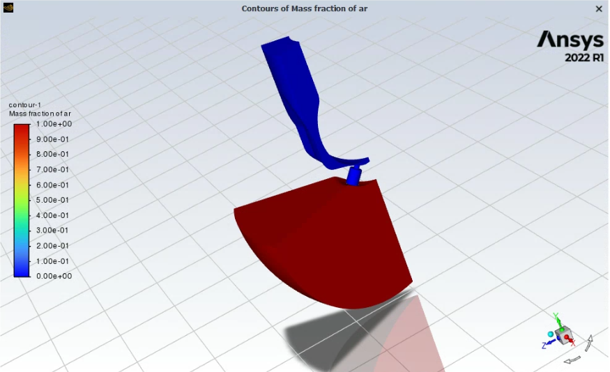

      For additional information about my case, I am using an eighth of a Spray G Nozzle geometry, injection (pressure inlet) pressure of 983700 Pa, outlet (pressure outlet) pressure of 98370 Pa, hydrogen gas into argon with the mixture template. The operation is in steady state and laminar w/ viscous heating is turned on. Let me know if there is any more information that I can provide.

        I initialized the jet with a pressure inlet at the top at 983700 Pa with an initial velocity of -0.01 m/s. The pressure outlet is the curve along the bottom hemisphere region, set at 98370 Pa. As you can see, Argon is set up for the bottom hemisphere as the ambient and hydrogen is filling up the rest.
