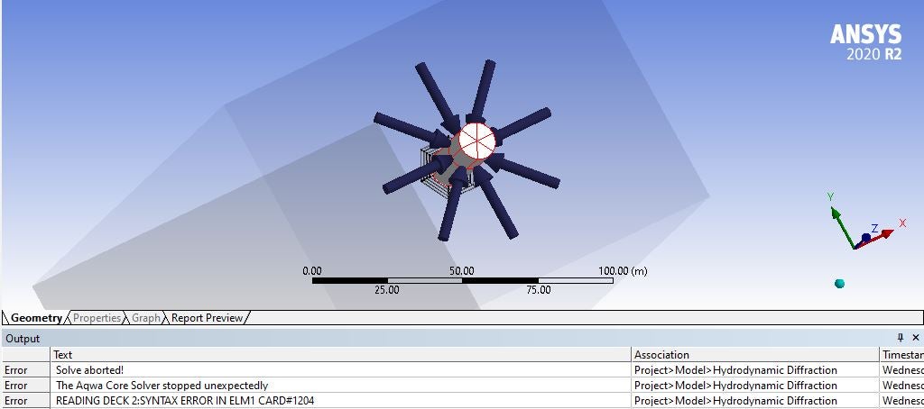

      Currently I'm doing my BSc thesis and I needed to do a model of circular cylinder for Ansys Aqwa. While running the analysis in hydrodynamic diffraction this error message is showing. If anyone can help me, it would be very beneficial.
    • Mike Pettit
      Please open the solver files directory for this analysis in Windows Explorer - if your project is saved as 'MyProject.wbpj', the solve files directory will be located in MyProject_files\dp0\AQW\AQW\AQ\Analysis. Open the Aqwa input file, ANALYSIS.DAT, using a text editor (e.g. Notepad). Scroll down through the file to see if there is anything unusual, for example an error message (just searching for 'error' might help). From the Aqwa output in your image, it looks like there is a problem in the element data. Please screenshot anything you find (don't attach the DAT file itself - as an Ansys employee I'm not allowed to download it from this thread).
      We have encountered problems with imported geometries (i.e. not created directly in DesignModeler or SpaceClaim) which include Line Bodies, where the vertices of adjoining lines are not exactly coincident. Please check the geometry carefully to see if there are any very short line segments.

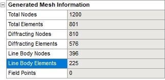

      The meshing deatils shows this message.

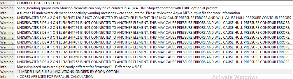

      Dear Mike Pettit, thanks for your reply. I run the problem in ansys aqwa and somehow reach to a solve. This time no error message in ANALYSIS.DAT file. But there is warning messages saying the elemens aren't connected. Is there any way to check the co-ordinate value of those elements? Because It's necesaary to know the location of the elements which are creating those warning messages.Getting reply from you would be very benficial.

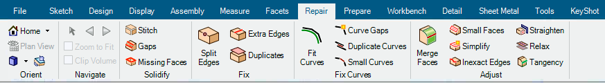

      What was the original geometry source you used to define the model? I guess it may have been an imported external file (e.g. IGES file), rather than created from scratch in SpaceClaim. You may find that the SpaceClaim Repair tools are useful here:
      For your model, you might try:
      • Stitch: combines disconnected surfaces into a single surface body
      • Gaps: fills small gaps between faces, which may be causing the 'UNDERWATER SIDE...' warnings that you are seeing; you may need to increase the maximum distance setting in Options - Find/Fix:
      • Small Faces: merges small or thin faces into adjacent faces, which may improve the mesh quality; you may need to increase the maximum area and width settings:
      Cheers, Mike
