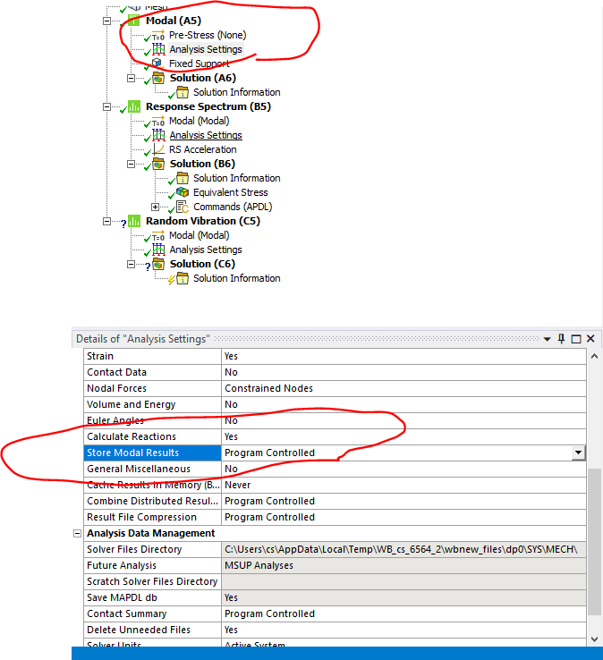

      Hi all,
      I am facing issue on Ansys Mechanical when trying to read random vibration results. Version 2019 R3. I run the solution in batch mode on HPC and import solution to Mechanical to read results. When I read result, mechanical crashes. Details are given in following link: /forum/discussion/36752/mechanical-crash-reading-solution-file-batch-mode
      I also have noticed that decoupling the system eliminates this error.
      I was wondering if there is a way to read results on mechanical without coupling the system with Modal analysis. I have tried a stand alone Random vibration module on WB to read these results however I get an error saying 'You need at least one structural load to proceed with the solution.'
      Is there an alternative way to read results of random vibration as I have the solution files of the system?
    • Chandra Sekaran
      Have you tried changing the settings for 'Store Modal Results'. I think setting it to YES helped in a similar situation before.
