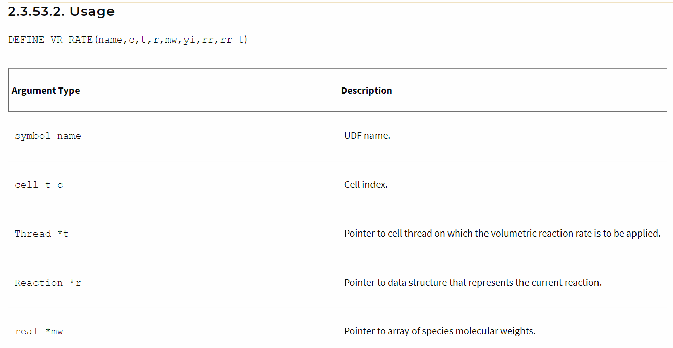

      For reference, here is the link of the definition of the macro DEFINE_VR_RATE. Please check out the examples below the theory of the macro for better understanding.
      2.3. Model-Specific DEFINE Macros (ansys.com) -> Check section 2.3.53
      Additionally, I see that you have defined mole weight and assigned it to the variable "mw1". However, you have not used this variable anywhere. You might want to remove unncessary variables from your UDF.
      If you are not able to access the link, please refer to this forum discussion: Using Help with links (ansys.com)

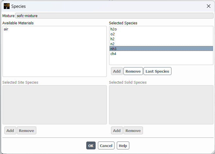

      can you tell me what is the species index if I have total of 6 fluids in the mixture? i want to get the mole fraction of mixture-material no. 5 where total 6 are given.
      thankyou

      Please refer to the 3rd link I shared above and the corresponding section.
      Here, “mw” or in your case “mole_weight” is the pointer to array of species molecular weights. You can simply access the species by using the correct index of the species inside the array. This array is directly passed by Fluent solver to the UDF so all you need is the order in which the specie are defined in Fluent. Accordingly, you can specify the correct index for the species you want.
      Thanks!

      i couldnt find the index numbering starts at 0 or 1. so in my case I am giving the reaction rate for ammonia decomposition and ammonia is the fifth material in my list of mixture-materials.
      so do I give the index 4 (if index numbering starts from 0) or should I give the index 5 (if the numbering starts from 1).
      Thankyou.
