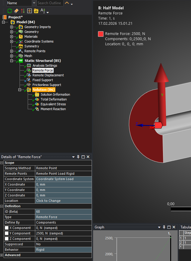

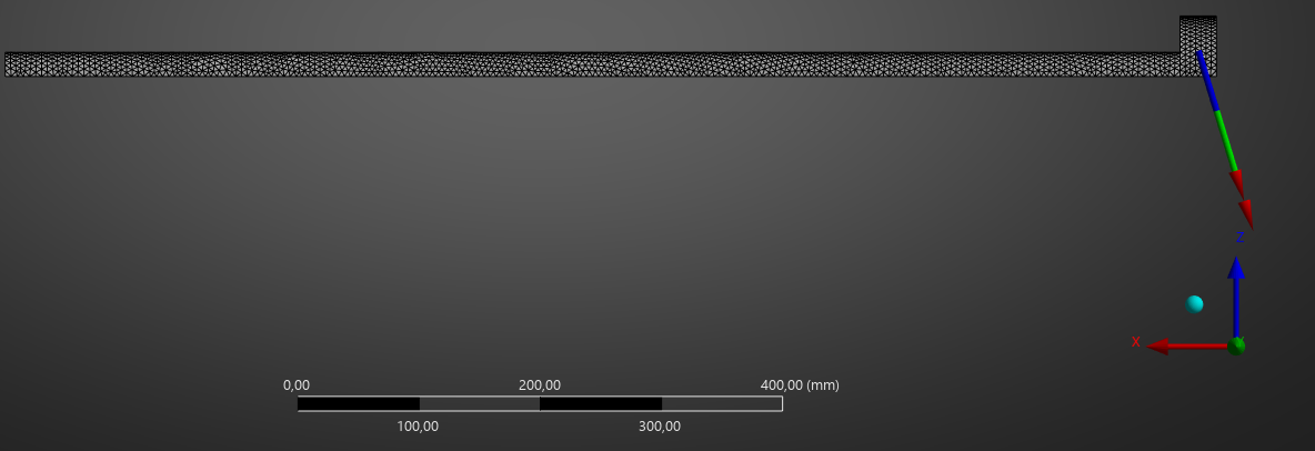

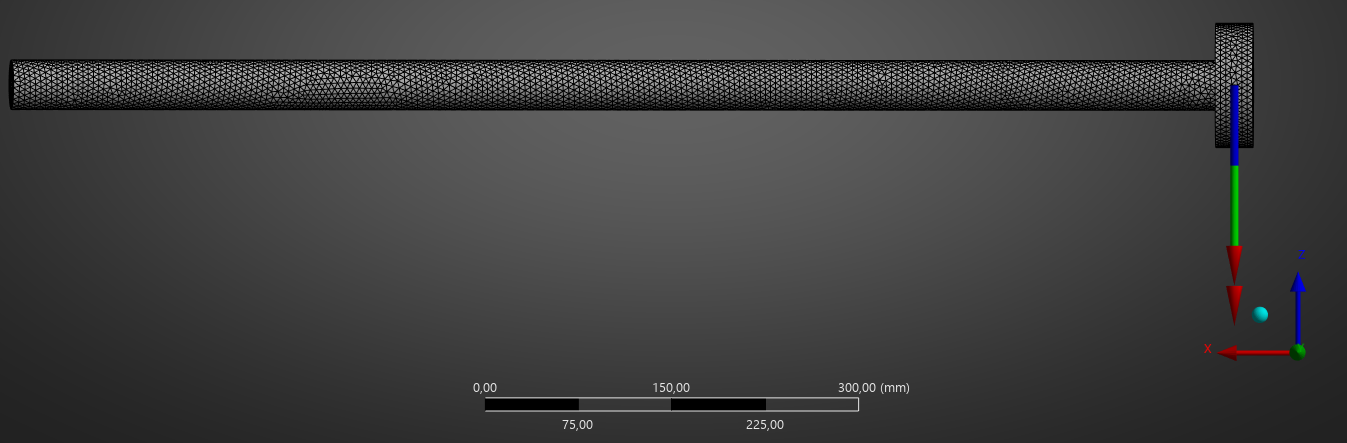

      I have a test model of a flange and pipe (one single model) with 6 bolt holes. The total length is 1000mm
      A perpendicular load of 5000N is defined on the tip of the pipe
      the 6 bolt holes are fixed.

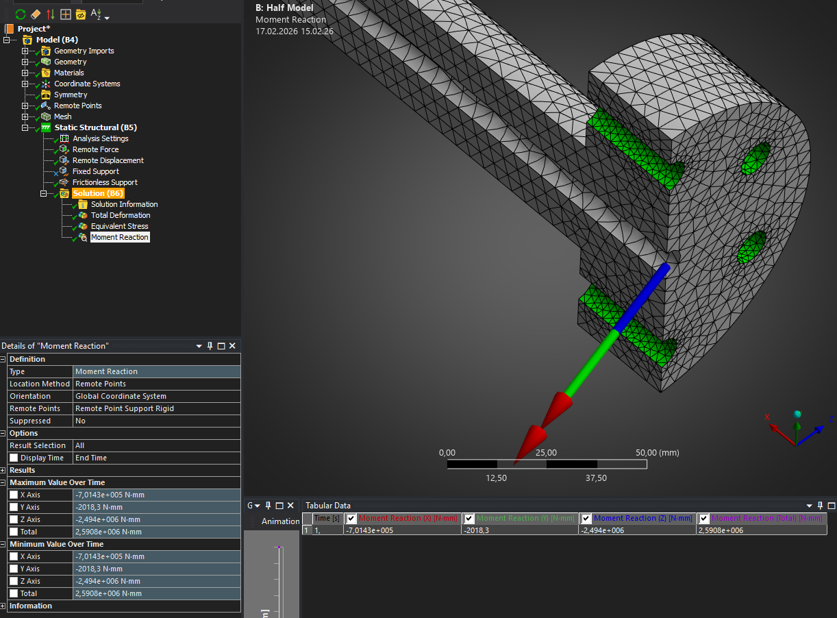

      For the full model: the reaction moment is pretty much as expected with near zero moment about Mx and My. The total reaction moment is almost a perfectly aligned with Z axis
      For the half symmetric: the reaction moment about Mx and My is suddenly substantial and the total reaction moment is not aligned with Z axis at all.
      Any Idea why the symmetric version is not reporting the same?
      • load is halved for the symmetric case
      • both frictionless and symmetry constraints have been tried. Both respond the same.
      • Large displacement is enabled.

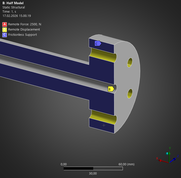

      Hi Deepak!
      I already tried that
      Here is my setup:

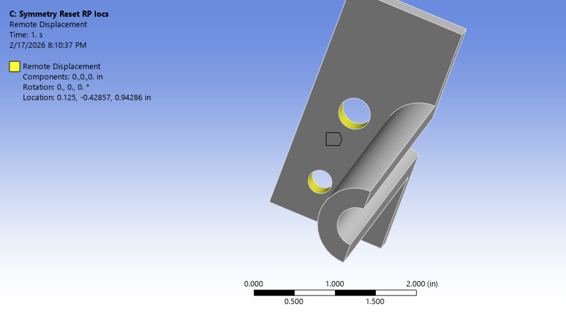

      This is expected to balance moments. Here is an example similar to yours, with calculations.
      The Remote Displacement x-direction Moment Reaction about the x-axis is: -12.961 lb in.

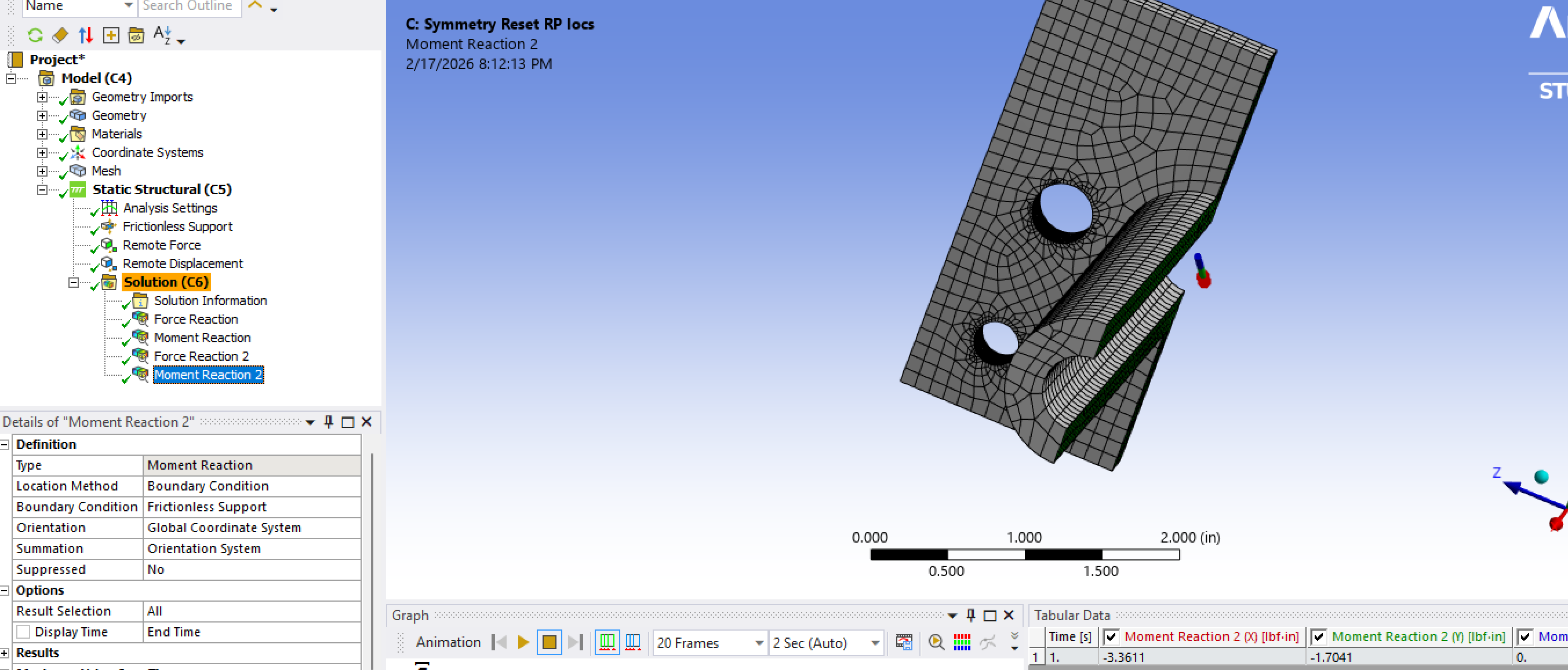

      The Frictionless Support x-direction Moment Reaction about the x-axis is: -3.3611 lb in.

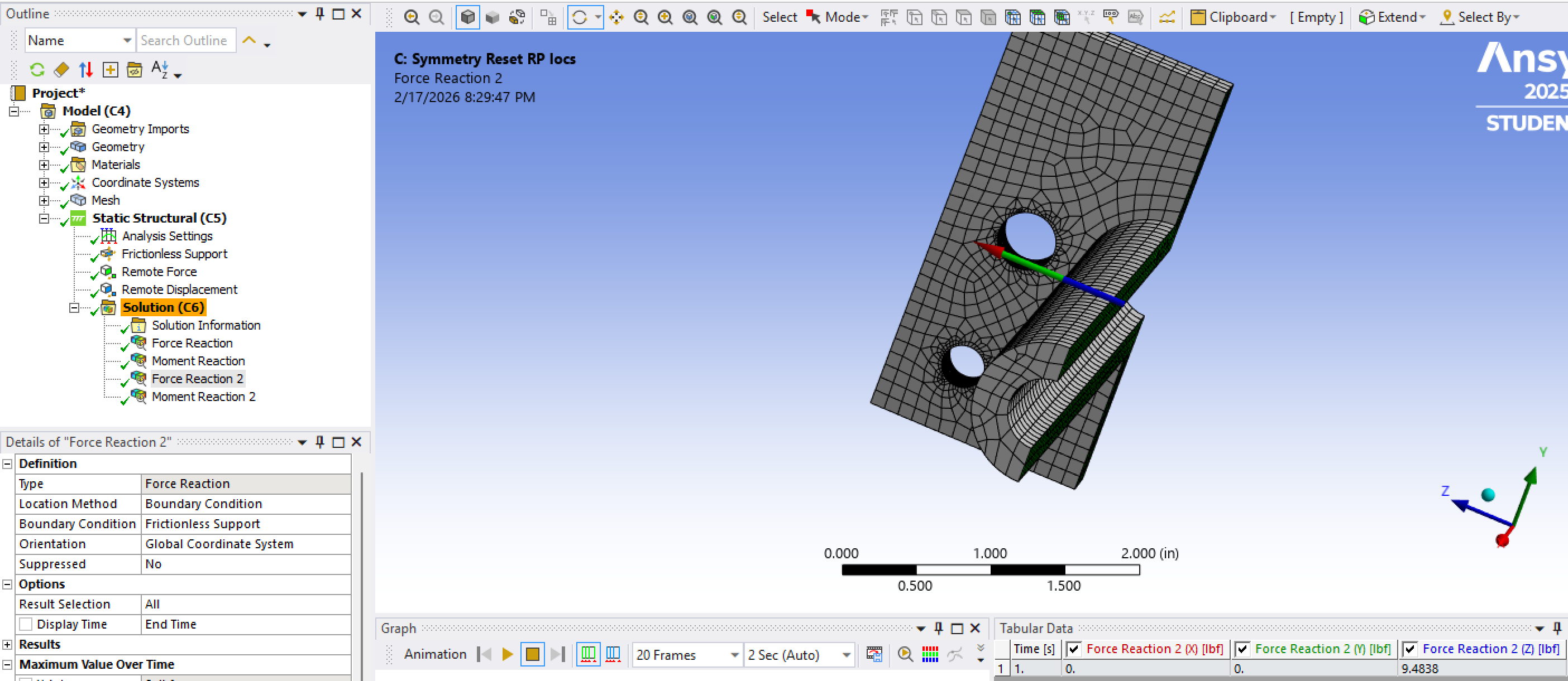

      The Frictionless Support x-direction Moment about the Remote Point center due to z reaction force is: 9.4838*0.42857 = 4.0645 lb in
      The total support reaction is therefore: -12.961 - 3.3611 + 4.0645 = -12.258 lb in
      The x-direction Moment about the Remote Point center due to applied force is: 13*0.94286 = 12.257 lb in
      So moments are balanced.
