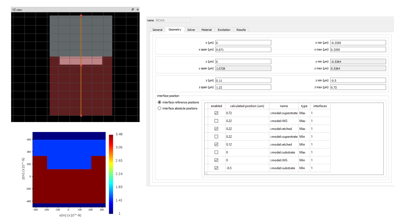

      Hi, could you help me understand how to define interfaces in the RCWA object? I'm simulating a Si grating on a Si substrate with a SiO2 superstrate. I'm using "interference reference positions". Currently, I only need one interface at each point, but the discretization of the index is incorrect. Could you explain how I should define the interfaces in this case?

      The "interface reference positions" are based on the maximum and minimum of each object in the simulation. This is why you see multiple points at the same location as the maximum of one object is same as the minimum of a different object. You can enable only one of these points (same locations) to be selected as the layer interface in the simulation. For example max(substrate) then min(etch) then max(etch).

      Thank you a lot for the response. This is what I am doing. But the first slab starts almost at -0.4 µm though the interface point is at -0.5 µm.
      The last interface is at 0.72 µm but in the index plot the last point is at 0.6 µm. Why?

      the refractive index plot is not consistent with the geometry. WG MIN is at 0 µm, and the total WG height (WG MAX = etched MAX) is 220 nm.

      I tested your code. In this case, you should include, one interface at 0 microns, second at 0.12 microns and third at 0.22 microns. The substrate and superstrate should not be included as interfaces. But the simulation region should extend into the substrate and the superstrate so that the simulation knows which medium the light is incident from and which medium it is transmitted to. The schematic is shown below:
      That being said, as you said the index results provided by RCWA seem to be inconsistent. The co-ordinates seem to be shifting depending upon the location of the simulation region which is unusual whereas the FDTD index monitor is returning the expected results as shown below. This might be due to a bug. I will investigate it further and get back to you as soon as I can.

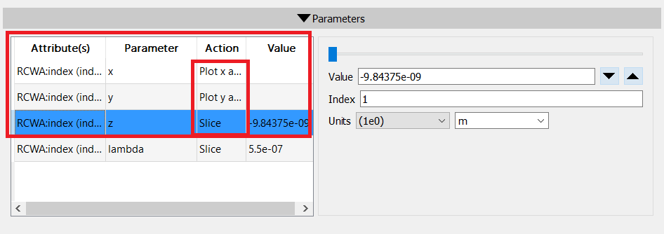

      Sorry I missed this post. In cases like this you can always create a new one referencing the old one. I had spoken to the R&D team on this. The issue here is because of an artifact of the visualization. There is only one data point for each layer in the simulation in the index data, placed at the position (along the propagation direction) in the middle of the layer. This means there is only one point for the substrate/cladding in the index data. The visualization then fills in half of the area between the substrate/cladding layer with the colors from the top/bottom layer in the visualization, creating this issue where the thicknesses looks different. I was told that the correct way to visualize the index data is to use view the transverse axes in the graph/visualizer. For example, if the propagation is z, then we should visualize the x and y axes. We should visualize the index in the xy plane, and the z-axis in the visualizer should be Slice. This means you view the xy plane for each value of z.
      This artifact does not affect the results of your RCWA simulation.
