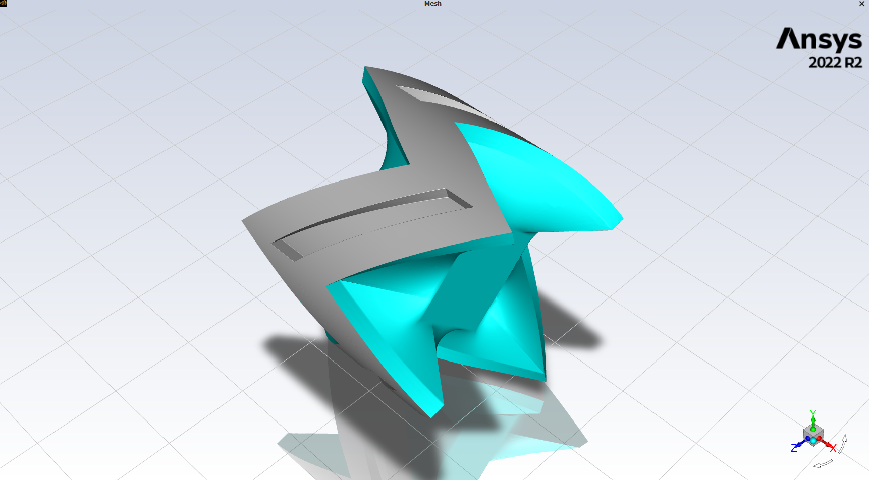

      I am postprocessing the thermo-fluid simulation of a rib roughened pipe with a structured grid in Ensight. The simulation was solved in Fluent with periodic boundary conditions, hence the jagged nature of the interface.
      I want to calculate the averaged axial (x) velocity over the radial coordinate of the pipe. Averaging in x direction was possible with a clip along the x axis to one outer wall and the radiograph mesh function and dividing the result by the length of the section. However, I cant figure out how to average the theta (circumferential) direction. Adding many clips along the circumference and manually averaging would be extremely laborious, as I have several variations of the geometry, and the radiograph mesh function takes quite long in itself to plot. Is there a smarter way to do this in ensight?

      A Screenshot from ensight is below
      Do you mean create a function for the spatial average of the variable of interest, and evaluate that over surfaces of constant r, with a sufficient amount of isosurfaces to represent an average? That sounds like a good idea. How can i then create a plot from this data in Ensight? putting a Line tool perpedicular to the isosurfaces produces an error. Thank you very much for your help thus far
      Not sure. In Fluent I'd create the iso-surface(s) of constant radius and then create an iso-surface of constant axial position whilst the radial surface was selected to leave a line. Then report data on that. Can you replicate that in Ensight?
