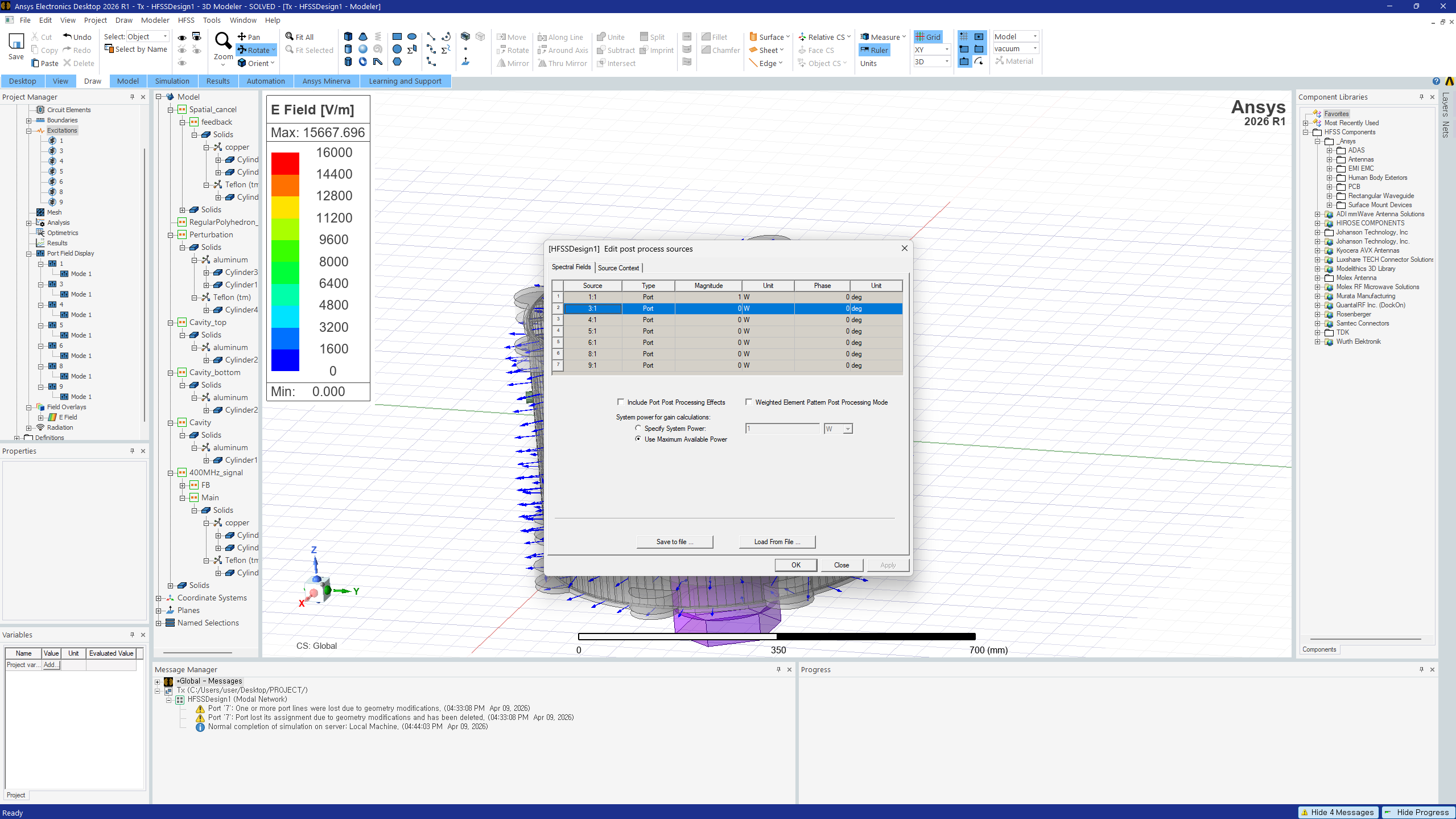

      please can you help me plot the modes after simulating my transmitter cavity i am finding a little difficulty
    • Takeshi Itadani

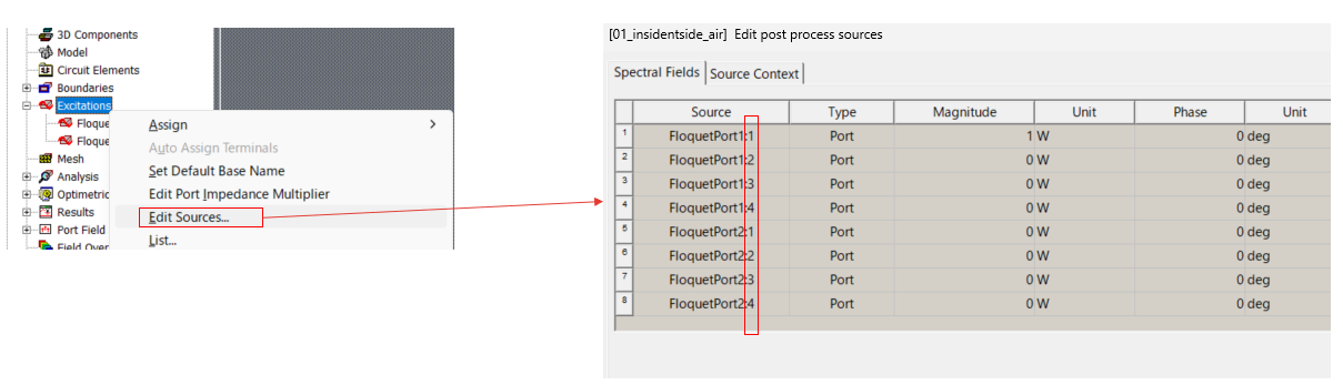

      To plot higher-order modes, right-click on Excitations in the Project Manager and select Edit Sources...
      In the Source column of the displayed screen, the ":#" after the port name indicates the mode. By entering a non-zero number in the Magnitude field for the mode you want to check, and entering 0 for the other Magnitudes, you can plot only specific modes.
      • derrick
        "In the Source column of the displayed screen, the ":#" after the port name indicates the mode. By entering a non-zero number in the Magnitude field for the mode you want to check, and entering 0 for the other Magnitudes, you can plot only specific modes."
        Please how do i plot the specific modes?

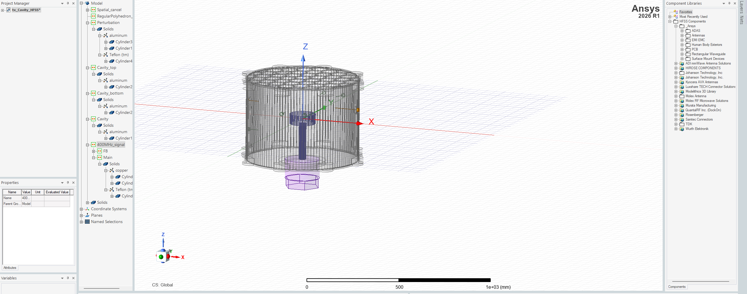

      since is a resonator how can i plot the field distrustion inside the cavity to see it its behaviour anythime i plot it seems the field distubution appear on the outside of the cavity
      As explained in the answer above, set the Magnitude of the mode you want to plot to a number other than 0, and set the Magnitude of all other modes to 0.
      How about placing a 2D sheet as "Unassigned" at the location you want to plot inside the cavity, and then plotting on that 2D sheet?

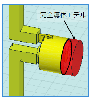

       since there is  space inside the ressonator how do i make a wave port inside the resonator because i want to feed the signal externally but only one modes appear but do you have any means you think i can go about it?
      also what about if i simulate it in eigen mode?
    • Takeshi Itadani
      To place a Waveport in the analysis space, it is necessary to make contact with an object on the opposite side from the side supplying the electromagnetic waves using a perfect conductor, as shown in the diagram below.
      The red area in the diagram below represents the perfect conductor.
